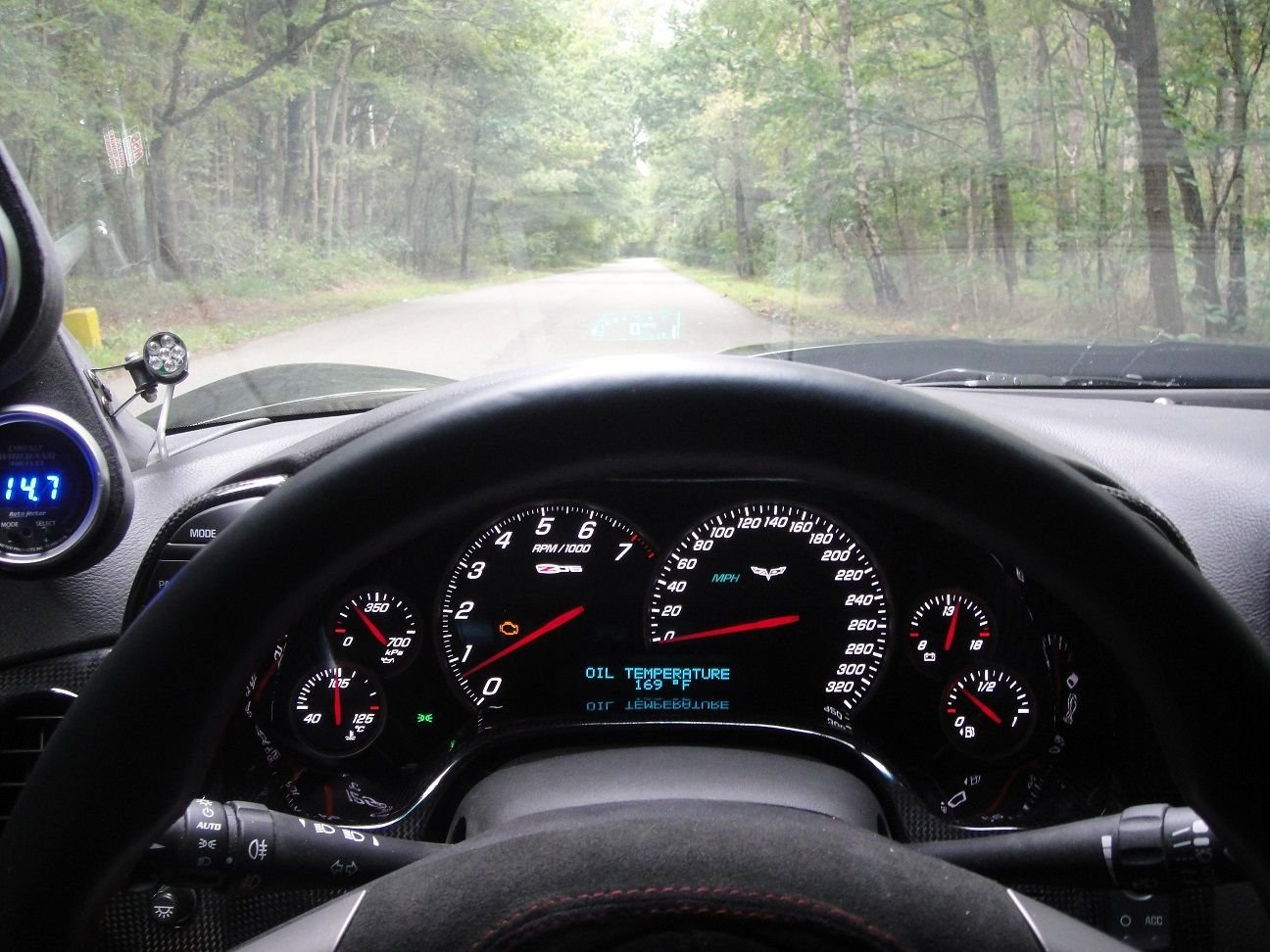

I have an SLP dash pod with and Autometer gauge/light.
http://www.jegs.com/i/Auto+Meter/105...FQiDaQodaaUDJQ
http://www.coloradospeed.com/images/slp/SLP90540A.jpg

Was it a plug in or require cutting and soldering????

I had to run a wires to the fuse box for the hot and and ground and one wire to a wire in the dash for the signal. I over killed a little. I have a GM PAC-connetor kit, so I connected it to the wires on the instrument and then ran the wires to the various locations. The pod tapes to the dash, no cutting and I ran the wires behind the dash panel.

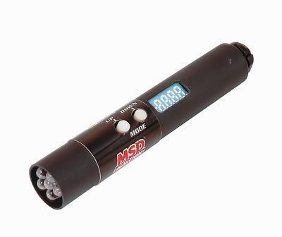

I bought an MSD digital shift light (part # 8963) from Summit Racing.
