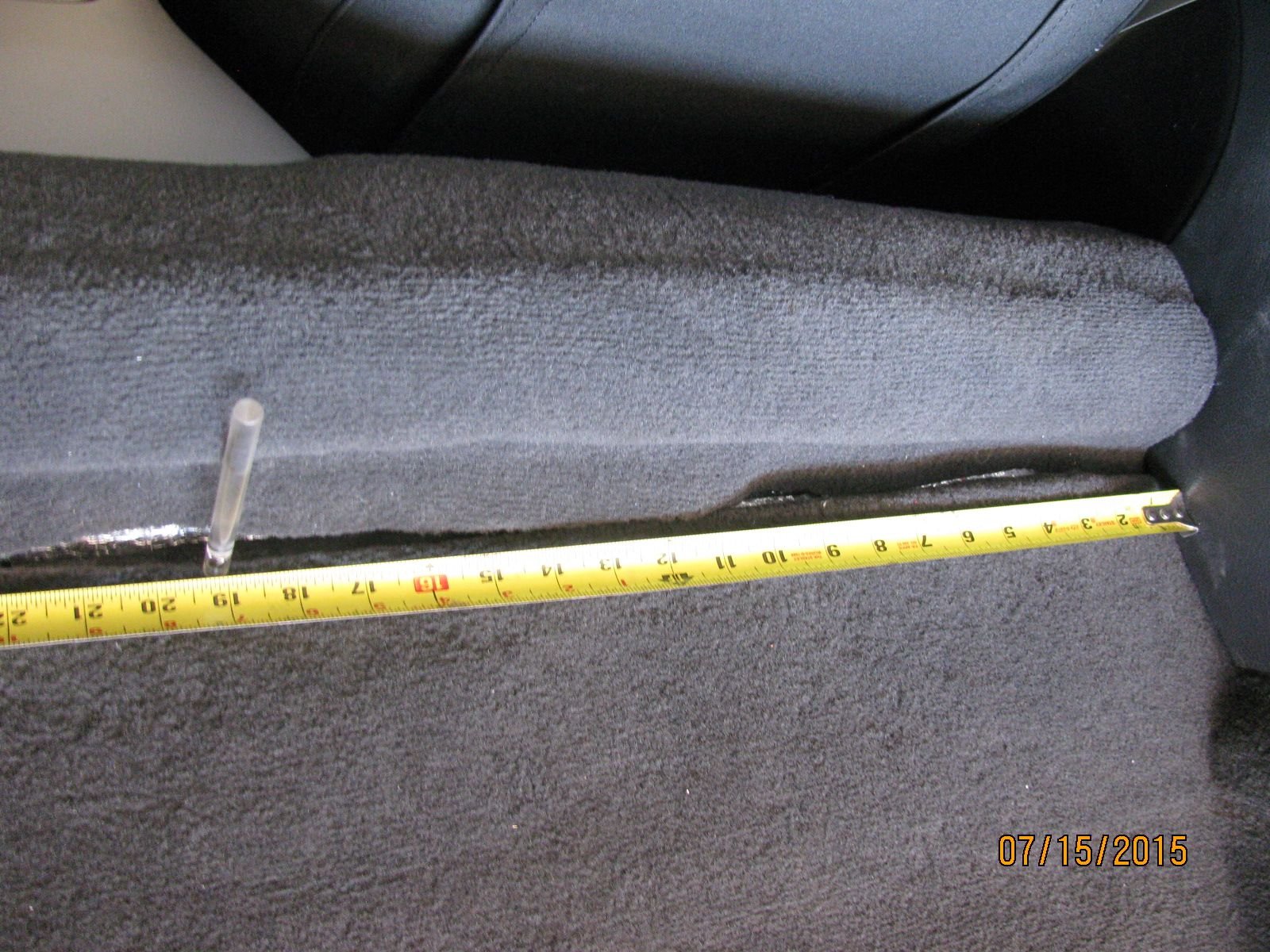

Yeah, I know it's not for everybody, but after several PITA drain and refills, I decided the next one will be much easier.
I'll be cutting an opening in the floor that's large enough to get my 90* needlenose pliers through to R&R the plug and insert a 1/2" hose with funnel. (or maybe just a long necked funnel) Of course, I'll make a patch to cover the hole when I'm done.
Here's a couple pics of the location where the scribe sticking up is directly above the fill plug.

Originally Posted by Dano523
Seems like the hard way around if you have a trans cooler.
Hence with a trans cooler, you need the car up off the ground so you can start to fill the trans, then let the trans free wheel to push fluid into the cooler and back, then finish topping the trans off with fluid.
With the filler in the car, then you are up/down to get it topped off, and still not a fan of venting any fluid volumes into cabin, much less taking a chance of spilling fluid into the cabin to funk up the cabin as well.
P.S, what are you using the car for that you are having to change the fluids that much, and why??? If the fluid is getting burnt, then it's time for a better trans cooler instead.
Swapping TC's 3 times and a bit shorter maintenance schedule due to racing and higher than stock stall speeds is why it's been changed 5 times in 126K miles. With the TC swaps, I drain the entire system and add nearly 14 quarts that include both the internal radiator cooler and the external cooler. The other changes are dropping the pan and then it only takes about 6 quarts.

Got the pump a loooong time ago and it's sort of a pain pumping 6 quarts at about 1/2 ounce per pump after a normal change by dropping the pan. But 14 quarts is a major killer, especially when part way through you have to get out and start the car to circulate fluid to fill the pump and get more space for the rest of the fluid. It ain't so easy anymore when you're in your 70's.
Cutting up the car a bit already happened a few years ago when I installed a rollbar. The last two times I needed to deal with fluid (14 and 6 quarts), I've used a longer hose through the rollbar hole, but I still had the hassle of R&Ring the plug and feeding in the hose. Pouring fluid from above is sooooo much easier than laying on the floor and pumping it. It's nowhere near as messy either.
After I cut the hole, I'll never have to get under to fill again.
I'm planning on removing the external cooler and the connections to the radiator cooler this Fall. I'll be adding dual external coolers and a 180* inline T-stat in it's place. Of course, I'll need to replace lost fluid, so that's when the hole gets opened up.
Maybe I'll video the hole cutting and new access method.
