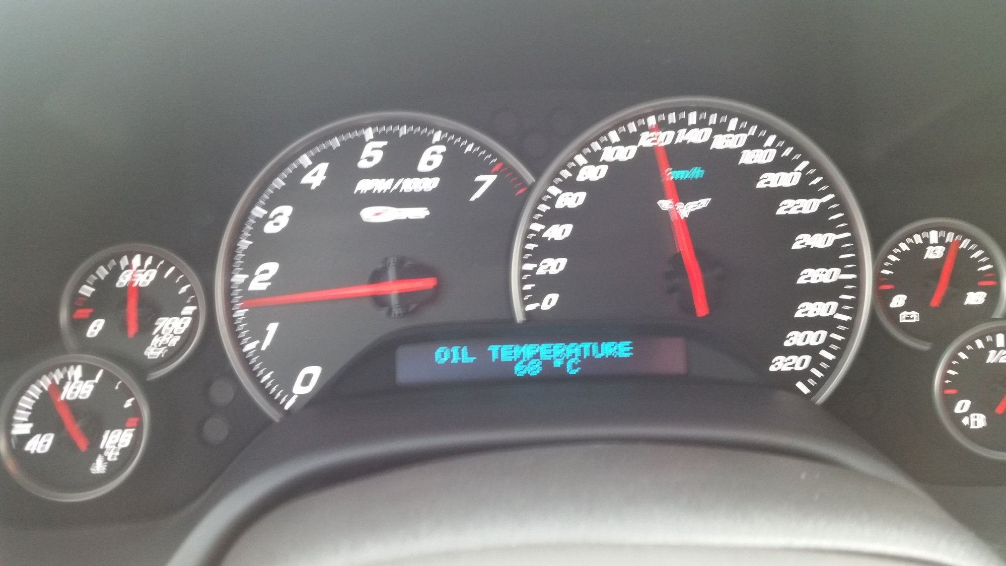

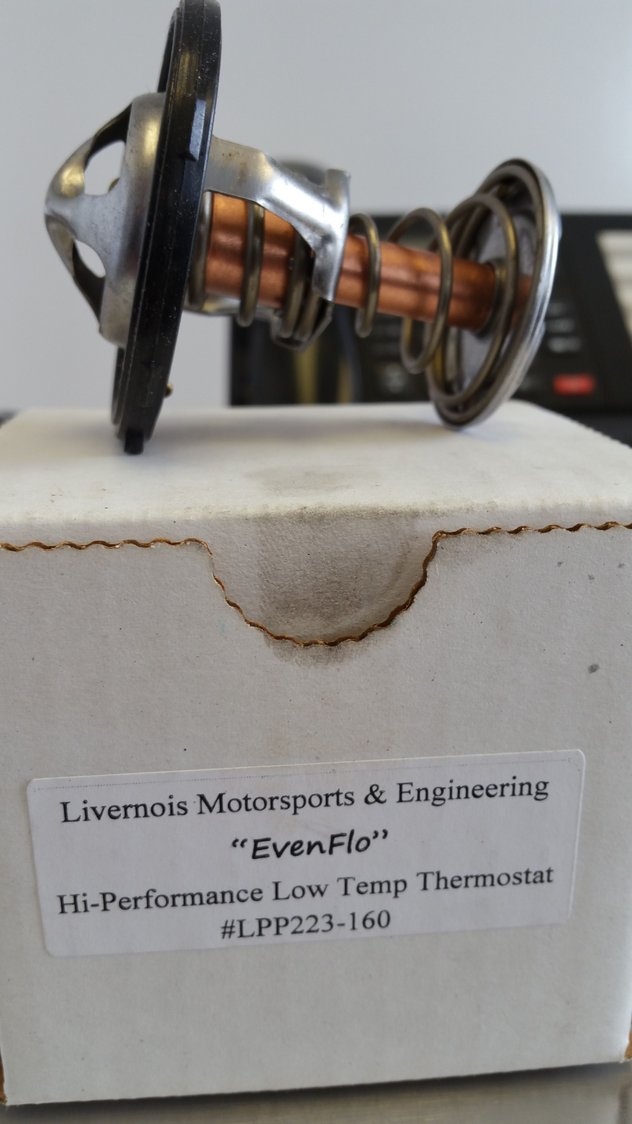

I have a 160 thermostat. keeps temps down which is always a good thing. Heat is an engine and oils worst enemy. Look how good cars run in cooler weather. In the cluster pic below (mines canadian so metric) I had been on a 4 hour road trip and was running pretty cool in very hot weather.
engine oil temp was 154.4F
engine coolant temp was 168.8F
Old Aug 22, 2015 | 02:14 AM
