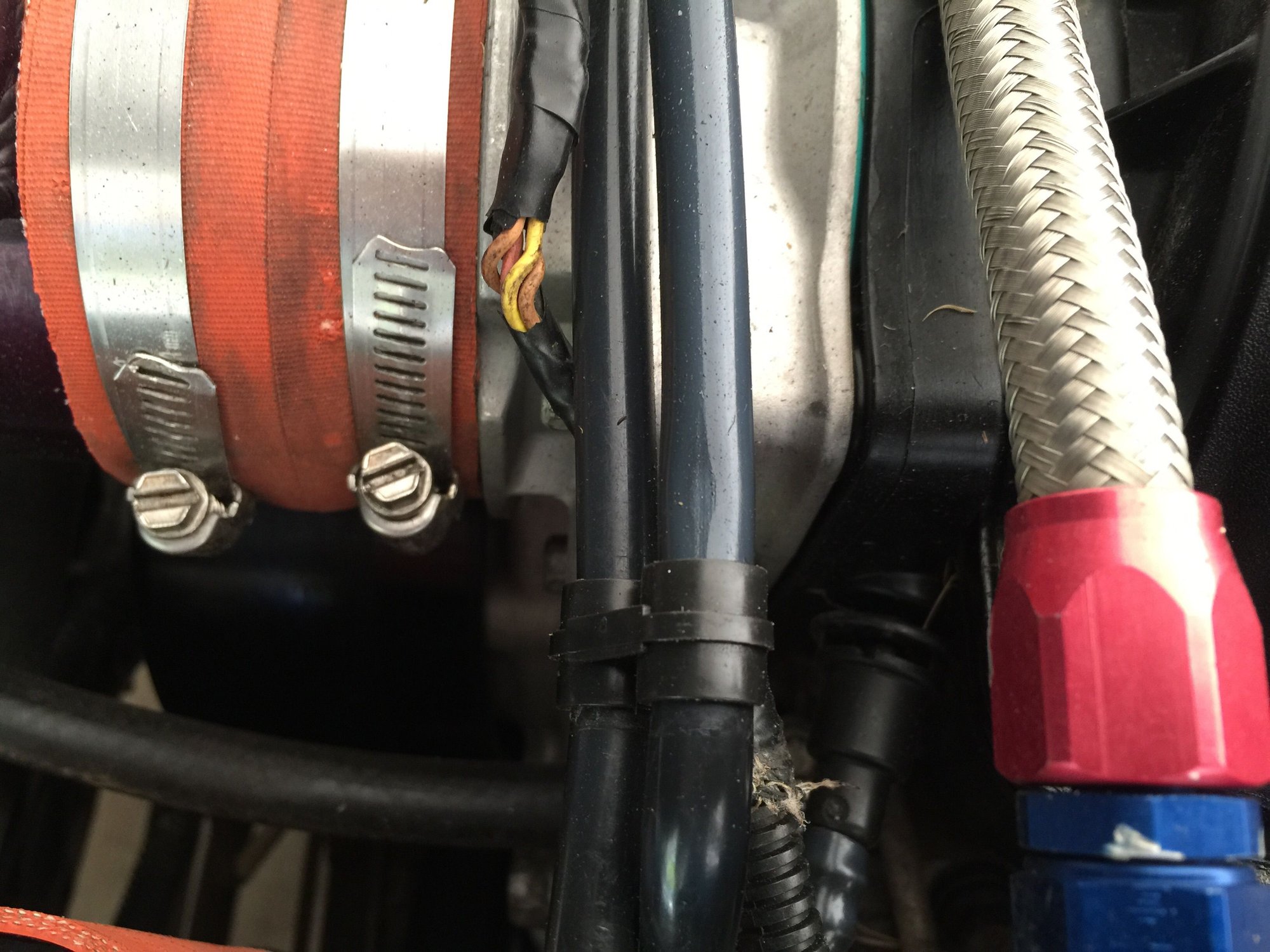

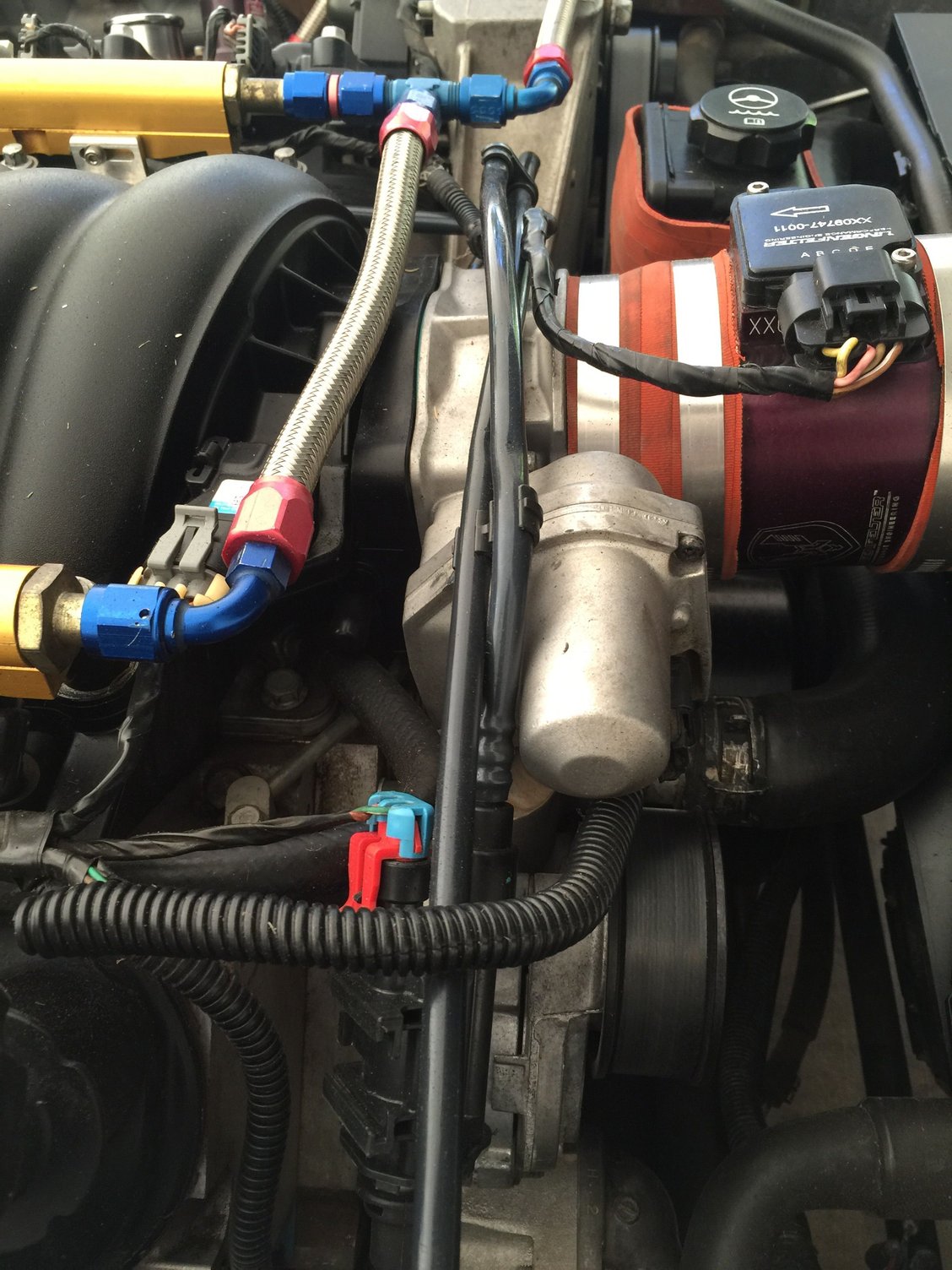

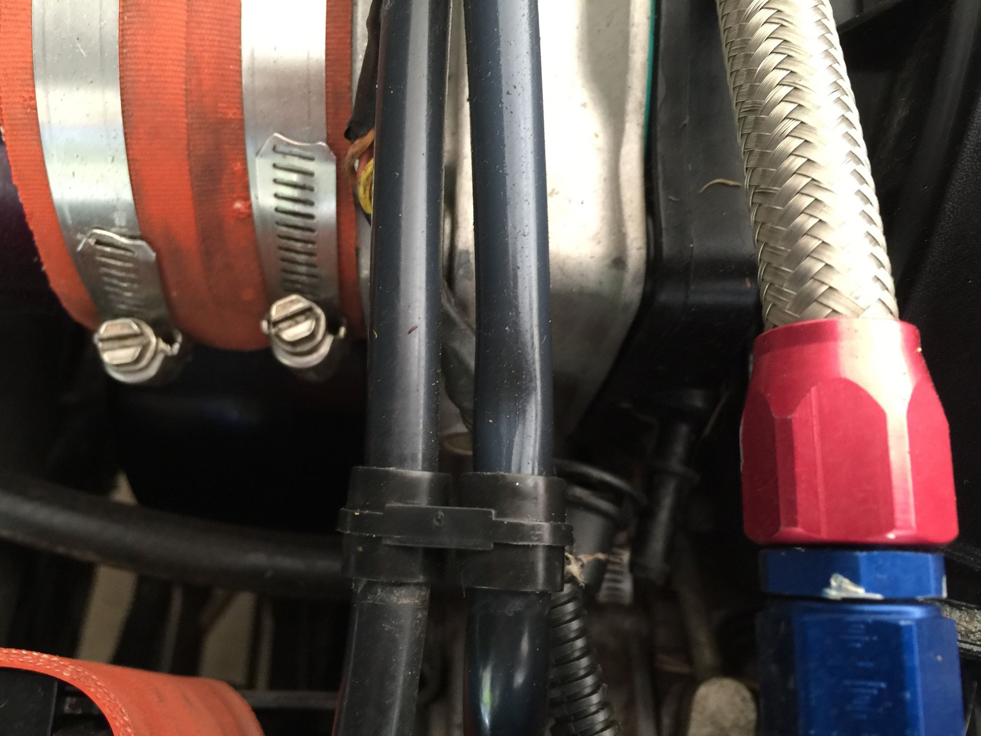

On the tubing running into the throttle body, I can very easily just slip off the connector by hand. Here are pics
With it on
With it off, that can't be right that I can easily slip the off.
Overall engine pic
Overall engine pic

The pictures aren't good enough for me to really see what side of the engine you're looking at. It looks like there are two issues.
1. You're missing a clip that holds that evap line on to the intake
Since you don't have a supercharger that connection is never under any significant pressure, so I don't see it flying off or anything. But, it could still vibrate loose. It will be a significant vacuum leak without it connected.
I'd just order a new tube (comes with clip). Advance I think has some replacement clips but since you don't have one to compare to it's probably easier to just get a new one. They're cheap.. like $10 from GM
2. Is there anything disconnected in any of those pictures on the passenger side of the engine? If I'm seeing what I think I'm seeing, the barb just after the throttle body isn't hooked to anything. That is bad. That would cause a massive vacuum leak. Or, maybe it's just capped off. I can't tell.

If the barb you are talking about is in the second picture, yes it is unhooked. In the first picture it is hooked up. That is on the drivers side of the engine. I can remove the line from that barb with little effort, like all I have to do is move it off with my finger, and with how the motor rocks I could see it coming loose very easily. Check engine light went off again and hasn't yet come back on. Could that be causing it to throw the throttle body code?

Barb problem would cause a lean condition, since if the hose pops off, will allow air around the Maf (nstead of throught it) that was un-sensored into the intake manifold.
P2135 Throttle Position (TP) Sensor 1-2 Correlation ECM
With the code your getting, screaming loose connection/problem with one of wires for the TB, or maybe TB itself if ported caused problems with the TB position sensor instead (if the unit was fully pulled apart when ported).
Being an intermittent problem, leads me to believe a wiring connection problem instead.
