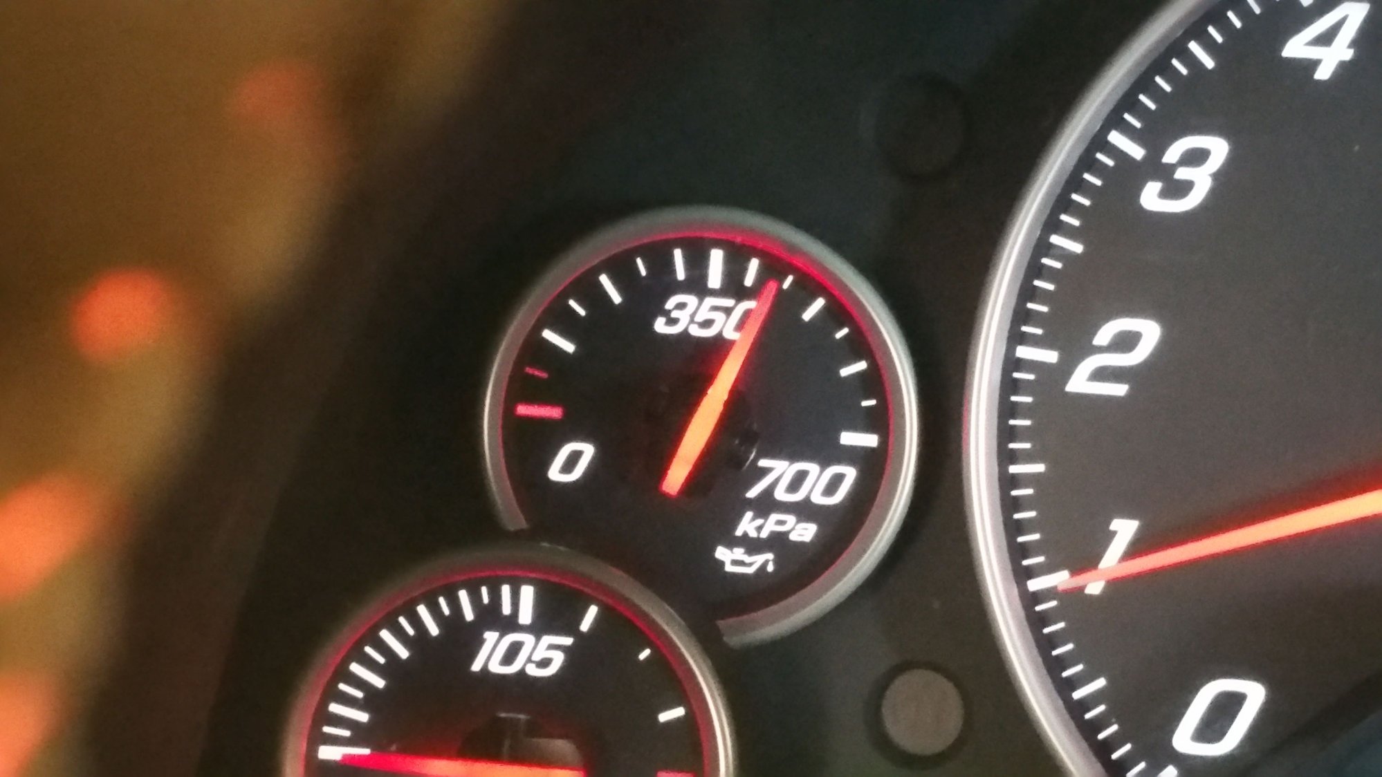

Here's mine cold idle, 62ish psi 5w30 royal purple HPS
