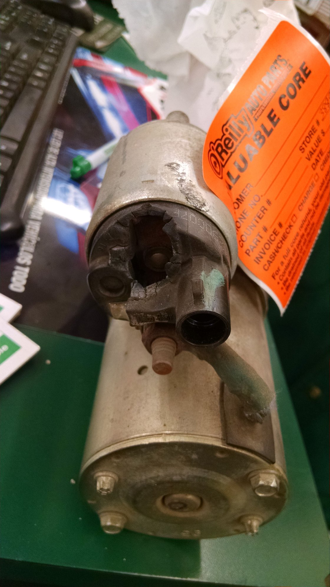

This is how the starter was getting with all the heat. This is the first time.

This was the second starter only 2 months later. Hopfully its good now. Just thought id share it.
You can get solenoids mounted at most auto electric shops for $30-40. Make sure there is some slack in the cables when installing. Tension will snap that post off quickly.

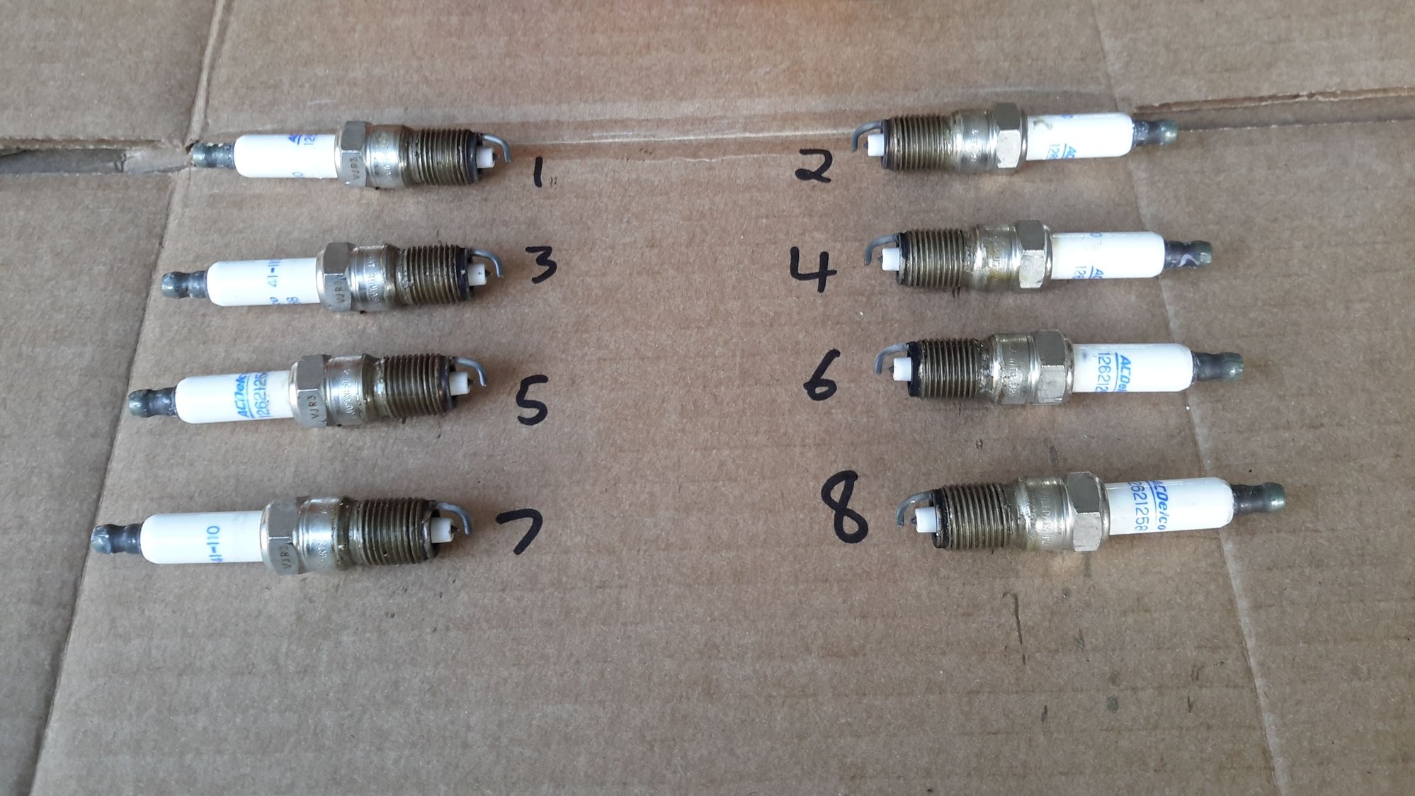

Most were 40 a couple were 45 and one was 50. Now all are exactly 40. <br/><br/>#6 had a little black soot on it.

Thsee were removed right after I turned the engine off after a 45 min drive home. I cleaned the MAF too. I did notice I was able to better seat a couple plug wires on the coil pack side. I pushed them in a little maybe a 1/8" or so.
I wasn't abe to fully check it out. Too many cops on my bacon detector lol. But on a quick down shift it pulled real strong and smooth. Tomorrow I'll romp it a little and see if it makes the gunshot style backfires.
