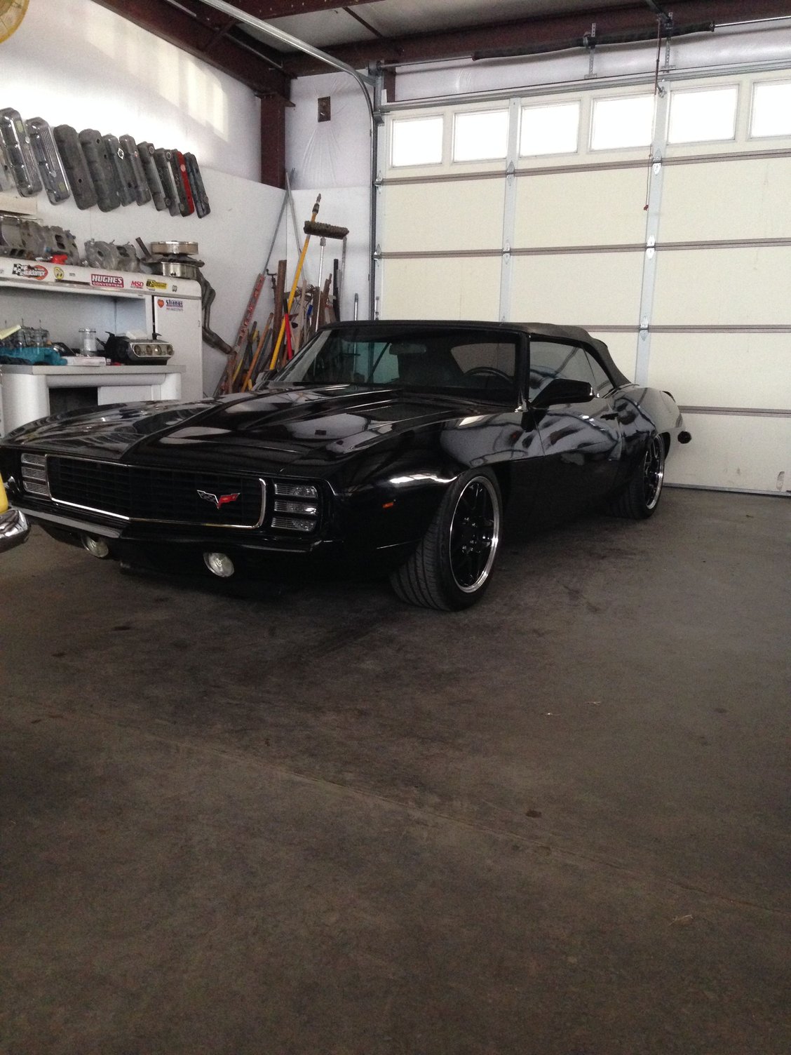

The first one we completed

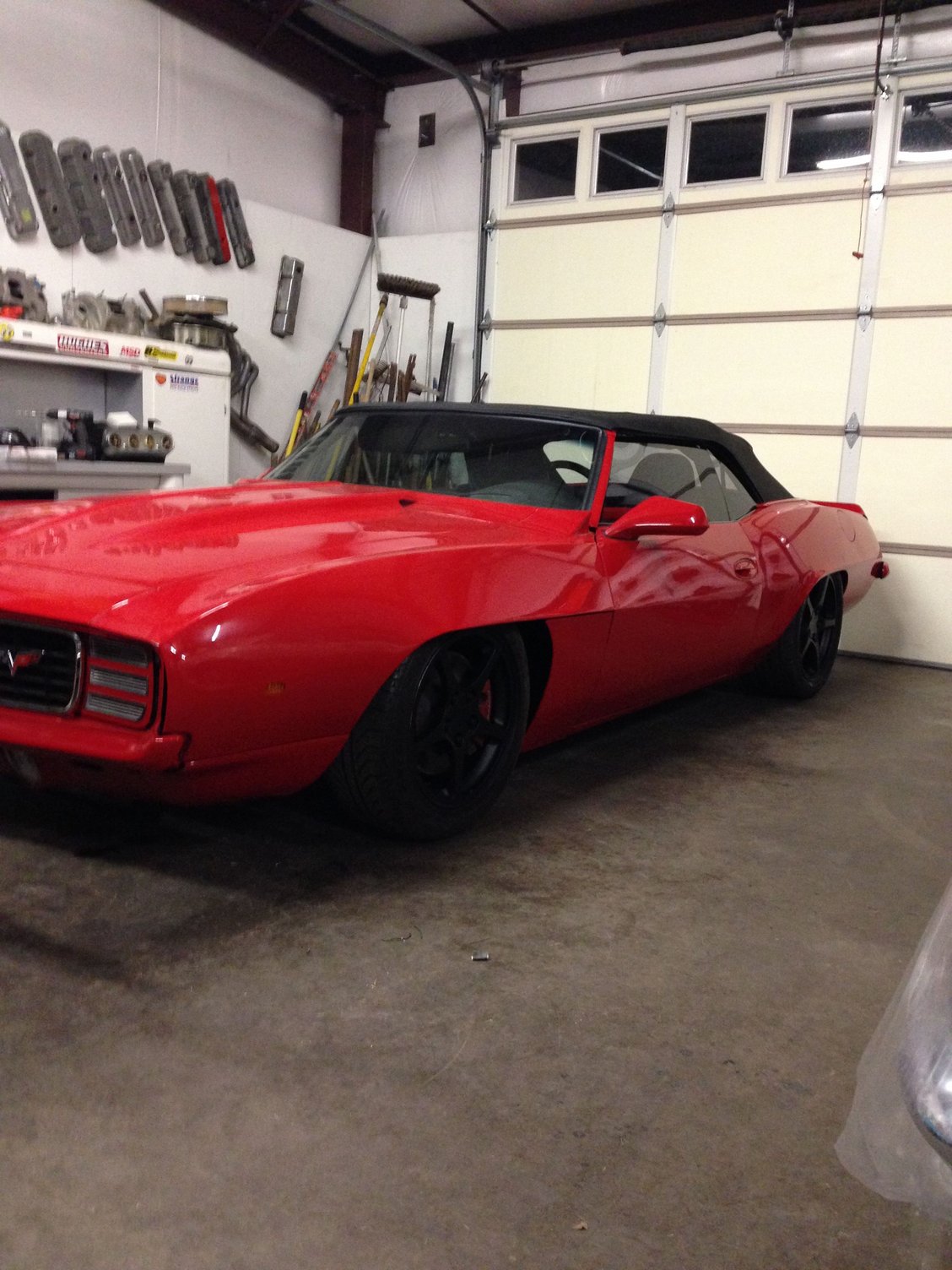

The second one we built
