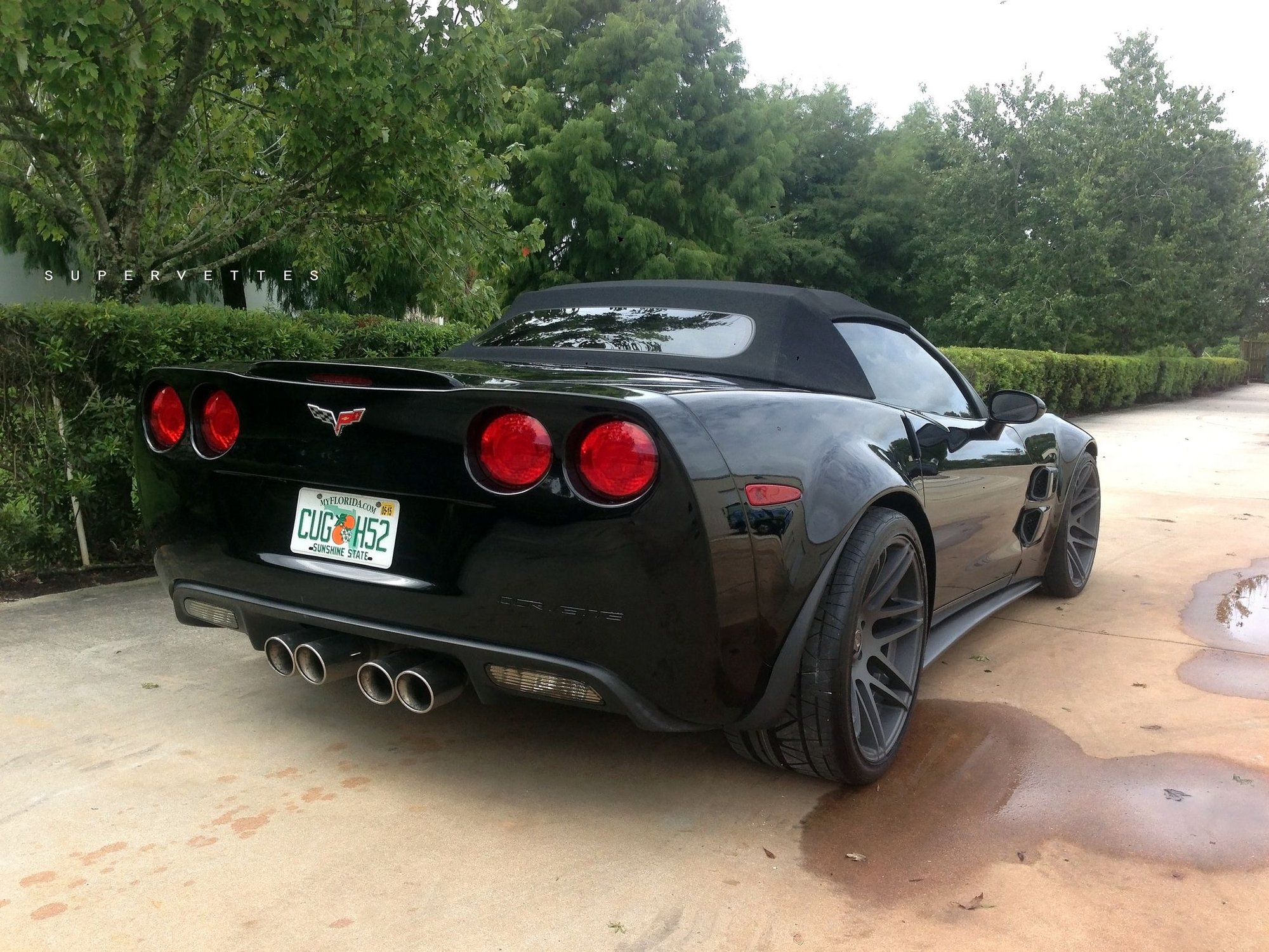

If you purchased your ZR6X rear quarters and wheels from us, please contact us via PM, email or phone with your full details and order number. (Just curious, why haven't you yet?)
We have used many Forgestar F14's on our conversions with no rubbing issues. However, 90% of the time, when someone orders their wheels from another source for our kit, there are always fitment issues.
Also, there are some cheap hand laid knockoffs floating around from vendors on this very forum that just are not made right, nor trimmed correctly, so that could also be the issue.
Either way, let us know and we'll try to isolate the issue.

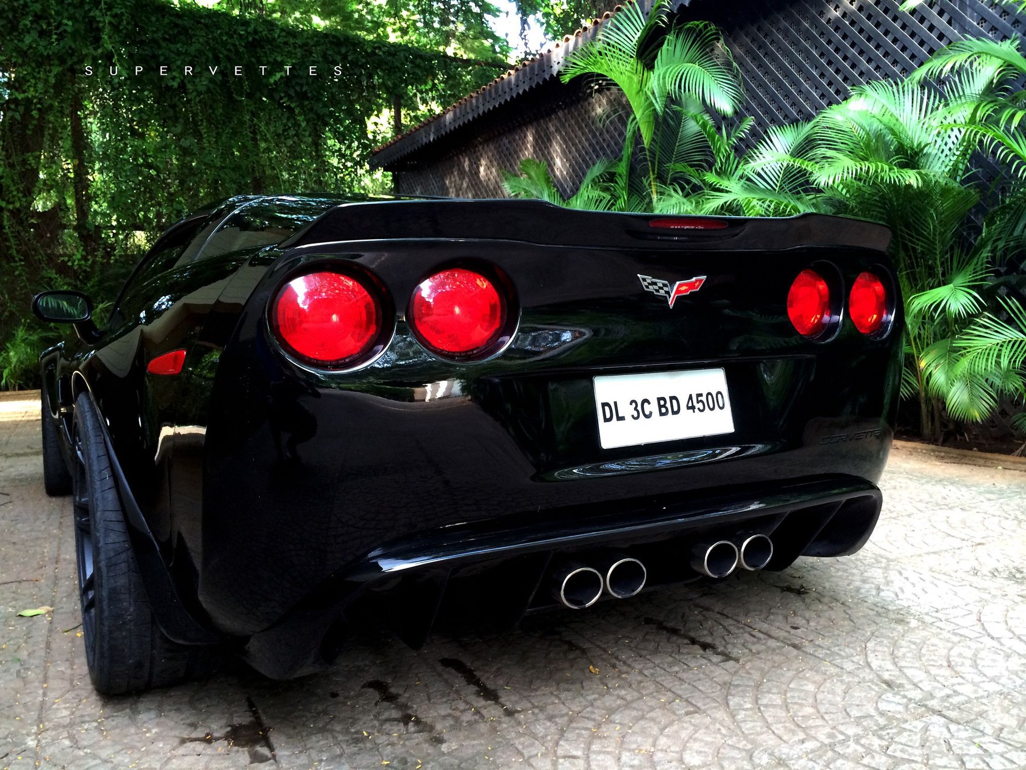

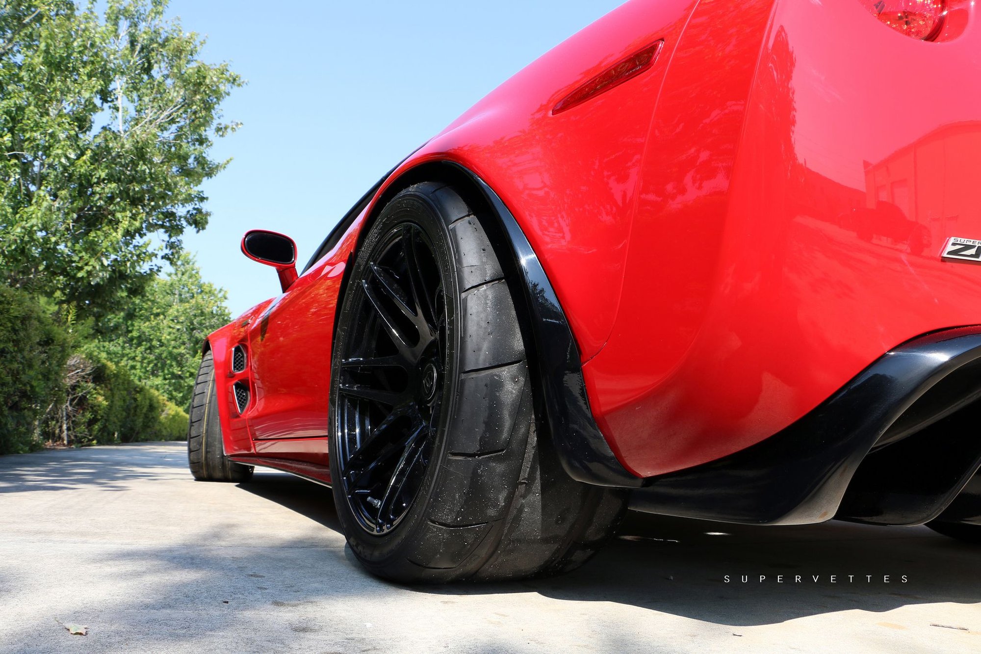

Here are a few of our F14 Superdeep builds over the past year that have no rubbing issues. I will preface this by saying, none of them had Bilstein sport shocks. They could have more travel and/or rebound than factory or coilovers which many of our customers use for an optimal stance.
To Bottoming out help!
