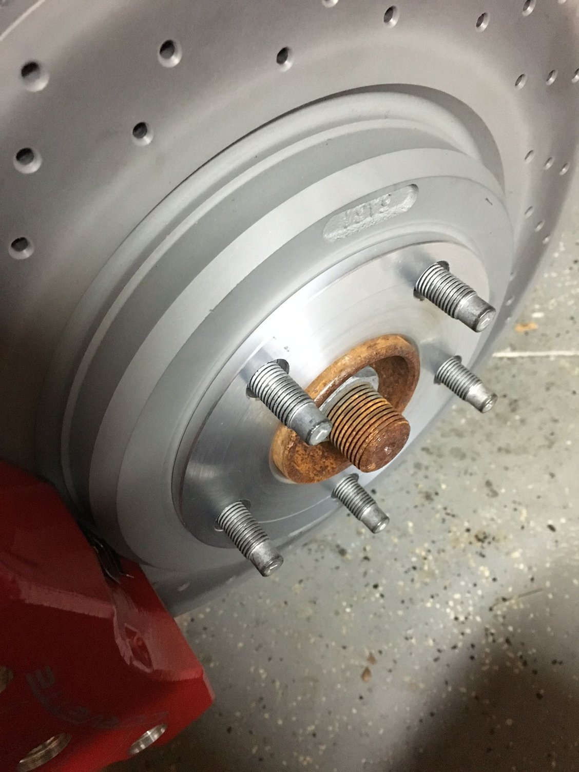

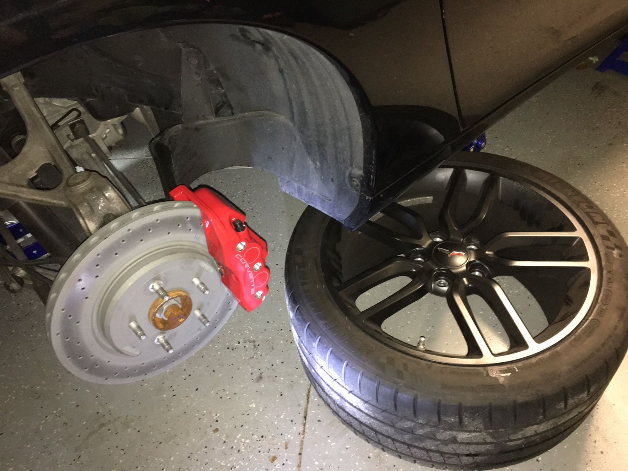

I just started my BBK upgrade to J56 setup from my current Z51 on my 2005.Prior to this I did a ton of research and chose a set of wheels I was told by the owner of the company would clear my BBK's (J56/willwood/brembo)....I purchased these from a forum vendor as well (florida speed shop). I found C7 Z51 in my needed 18/19 sizes so i literally just swapped my tires (new PSS's) onto them.
well...guess what the first wheel I started - rim doesn't clear ! Rim makes direct contact on caliper when lugs fully seated...GRRRR
I did some research and looks like MotorSport Tech (http://www.motorsport-tech.com) makes a hub centric option so I can still get the rim on the hub to avoid vibration, etc.
Anyone with experience/other vendor, etc??
FYI - I will be adding new SS lines ?(in the image below I stopped install when I got so mad at the wheel not clearing...)
the C7 wheels I purchased in my sizes of 18X8.5 and 19X10 (same offsets of +56 and +76)
everything bolts up as it should for the caliper and rotor to my Z51 spindle
OEM rubber line is too stressed, as mentioned I have SS lines I will install

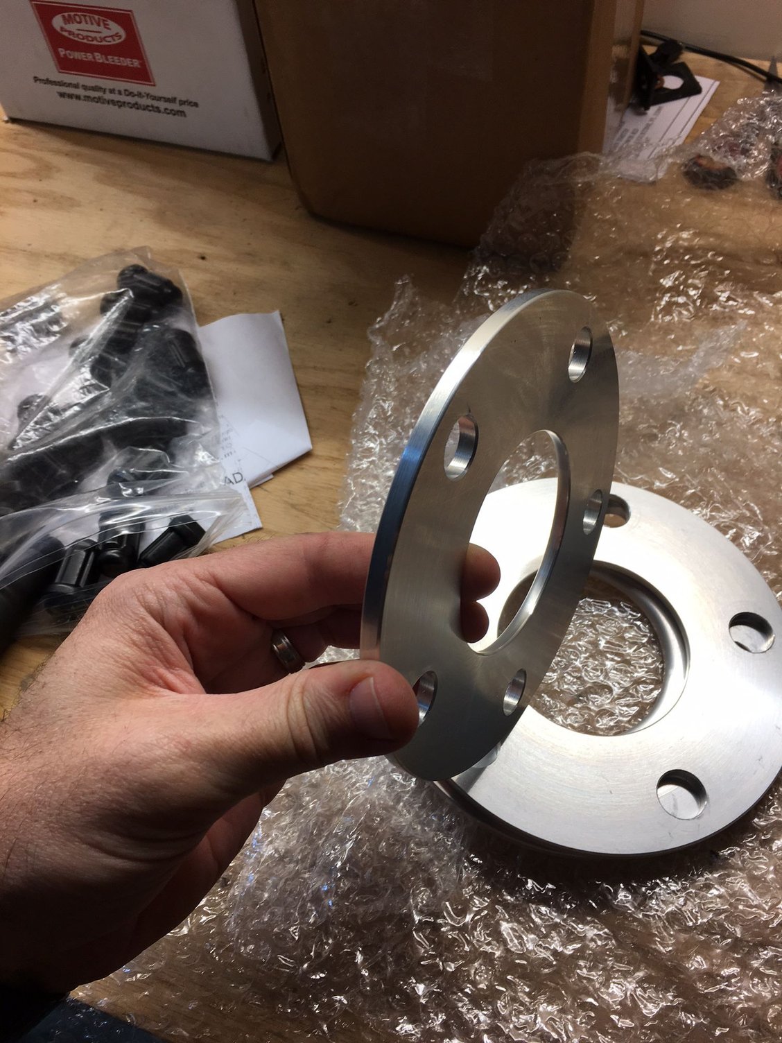

update here - I called and had a great conversation with Lenny Jr @ MotorSport Tech - My spaces and ET lugs are on the way, may have by Friday. I will post detailed pics of fitment, etc

Perfect that's what I ordered
1 12mm1.5 BLACK ET Spline Lugs Black with key
4 Spacer - Hub Centric 6mm, 5x4.75
Old Dec 3, 2015 | 12:16 PM

well I have a great update here...the spacers from MotorSport Tech came in and they are pretty awesome. My wheels fit, the ET lugs are great and I can torque them as expected

So I got all the spacers on and used the ET lugs...torqued all to 125 with no issues
