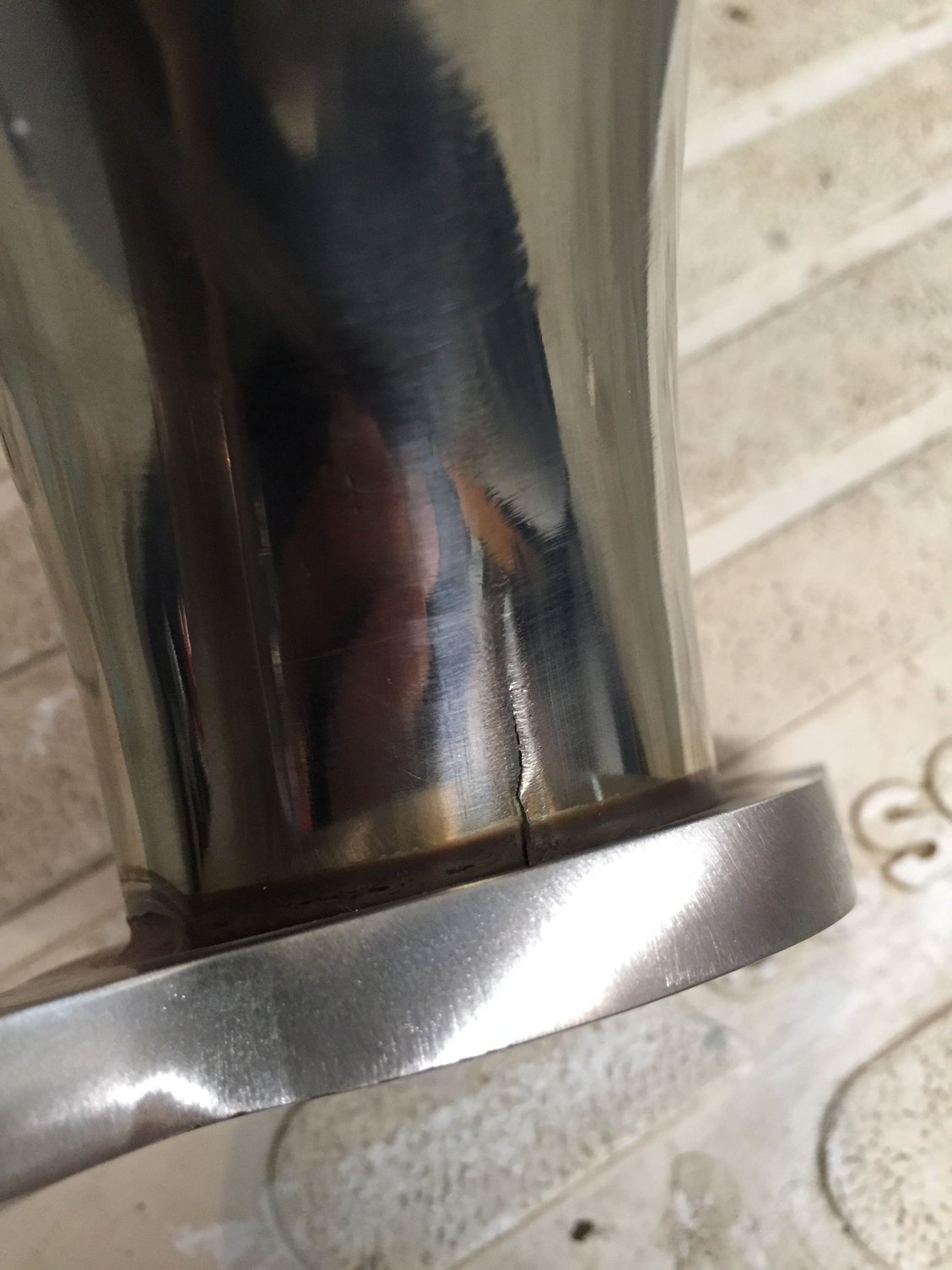

After buying a cheaper set the first time, i found out why the ARH cost more. I sent these back and paid the extra money.
Look at how the cheap SS cracked when they bent it. You could look down the tubes and see where they did some repair work to other cracks as well.
It's always scary buying off of third parties, not sure if you're getting a knock off.
That picture right there is why I wouldn't want to go cheap on exhaust. Not to say one of the cheaper exhaust won't last the length of time I own the car but why take the risk? It's not worth the risk to me. And that's why I felt as I was buying the headers they were a top quality product with B&B. I still feel someone was having an off day. It happens. But it means I won't be sending my money back to them. The headers were shipped out on the 26th and I should get my refund to put towards better quality here in a little over a week.
