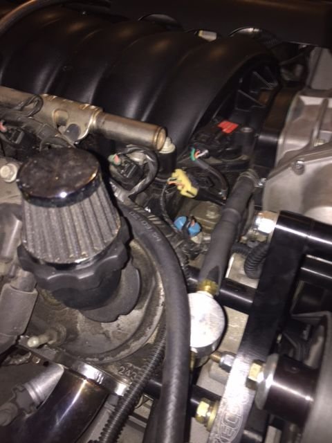

Do me a favor and pull your passenger side rail cover and take a photo of your PCV lines, and what you have for oil catch cans.
You should have a back check valve on the PCV line into intake manifold ( PVC valley cover to intake port) so your not blowing boost out of that port under boost, which means that your PVC clean ports out of the valve covers become the dirty side under boost, with the piston blow-by pressure being set to the PCV line on the air filter side of the S/C intake.
Hence if your TB is dirty, that that is coming from the PCV line to the intake side of the S/C out of the valve covers, and the inside of your S/C will be even more filthy than the TB was, since the TB is getting meth washed instead.
Hence on a S/C set up, you really want to run two catch cans, but if you are only running one, then you want it on the clean side to catch the oil out of the valve covers under boost, to the front of the S/C when the motor is under boost.
Go to post 55/56 and see the diagrams that I did for both single and dual can set up's for boost motors to keep the oil out of the intake manifold.
https://www.corvetteforum.com/forums...can-pic-3.html
And I bring this up, since if you MAF/TB is that dirty, God only knows what your 3 bar MAP sensor looks like now as well.
MAP (manifold air pressure) sensor is the one with the red label and may need to be pulled to be cleaned as well.

Regarding the oil catch can here is a pic.
So coming off the intake it goes into a special valve to not open when under boost, then into the catchcan, and then into the nipple coming from under the intake manifold. Then I have a separate line coming off the valve cover that for all intensive purposes goes into the atmosphere. And as you see the oil fill cap is modified.
When I said the original throttle was filthy I may of been dramatic on it. To me it was dirty but in reality it was probably normal for a vehicle with 74k miles.
