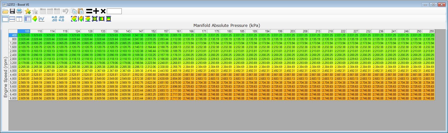

I looked over tune and don't see anything that would cause this issue (at least with what you can see in hp tuners). I was thinking somebody might have messed with the throttle maps but they are totally stock so that wasn't it
Your boost VE table looks a little weird but I'm not going to criticize the tune

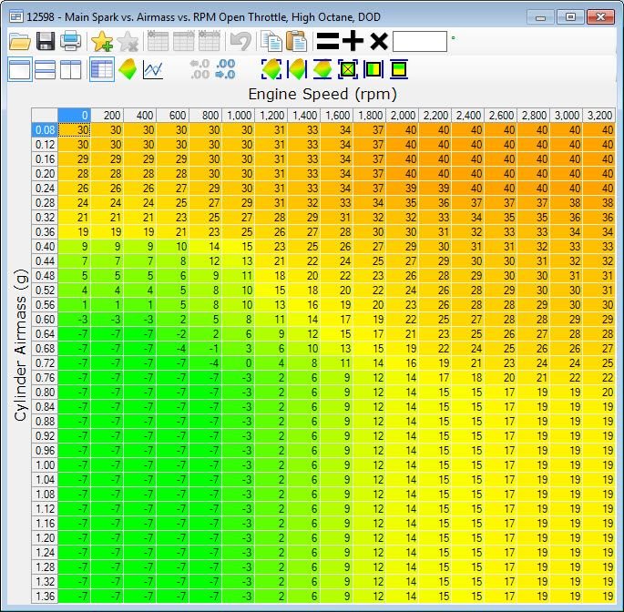

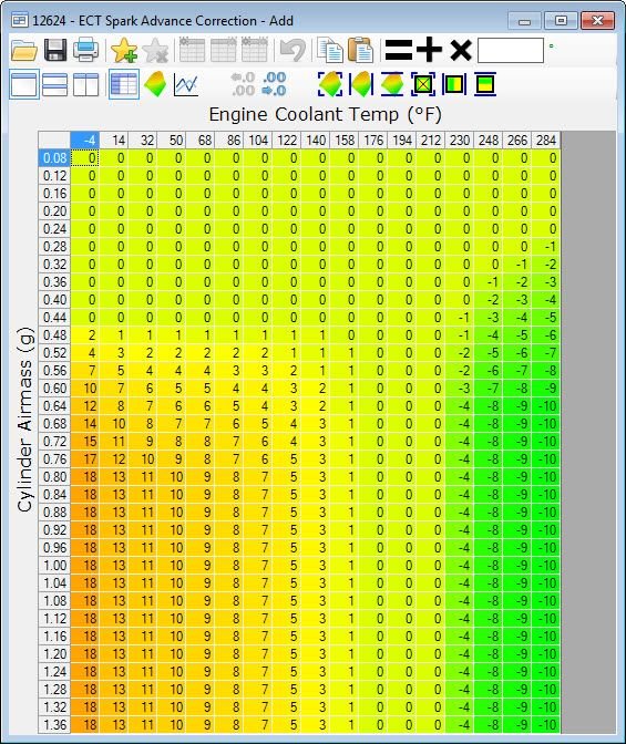

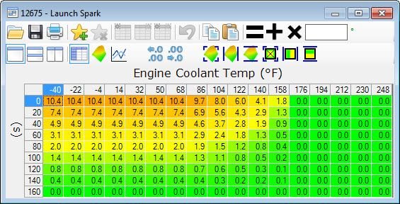

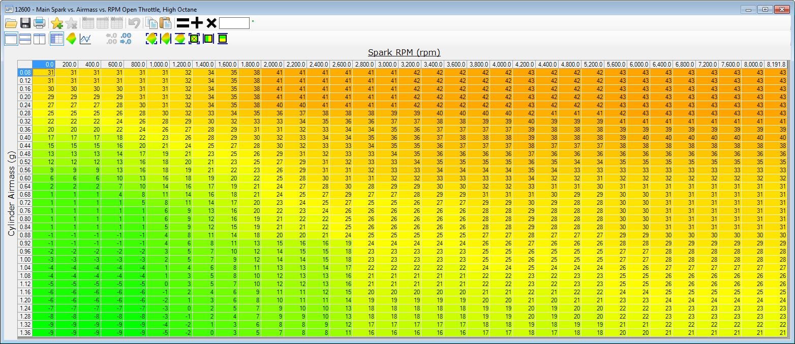

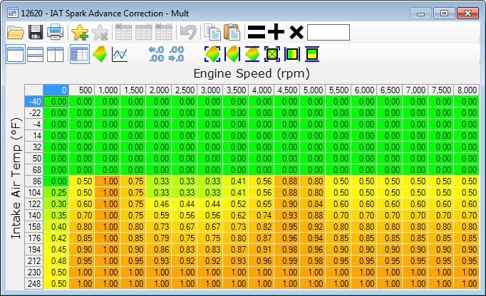

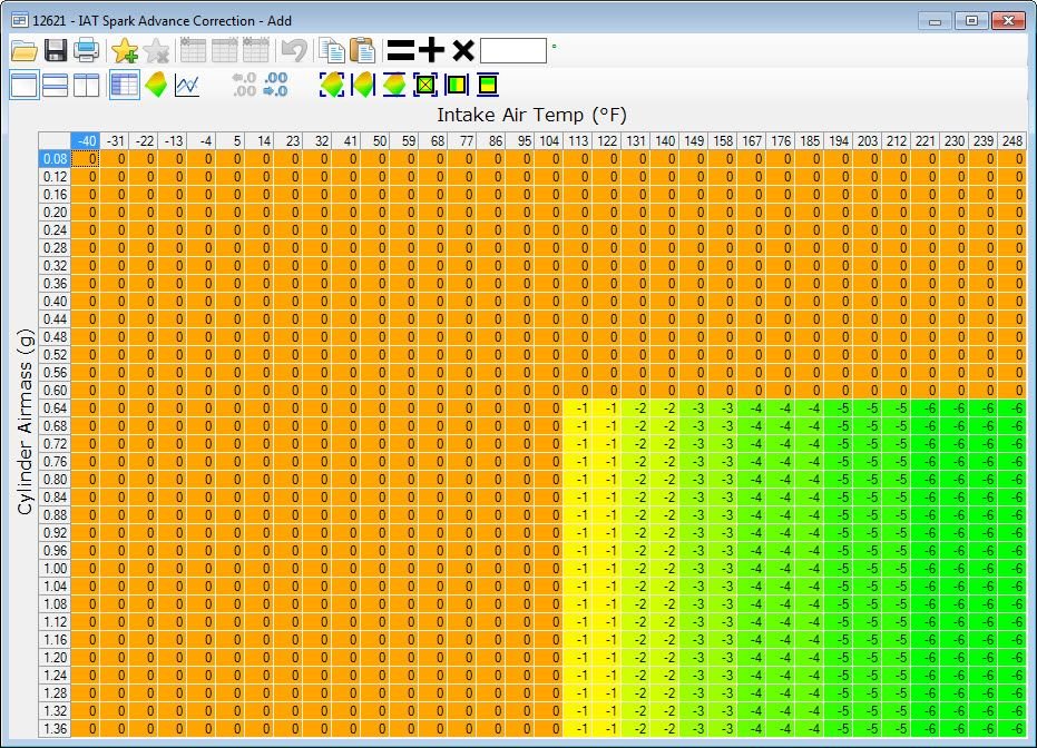

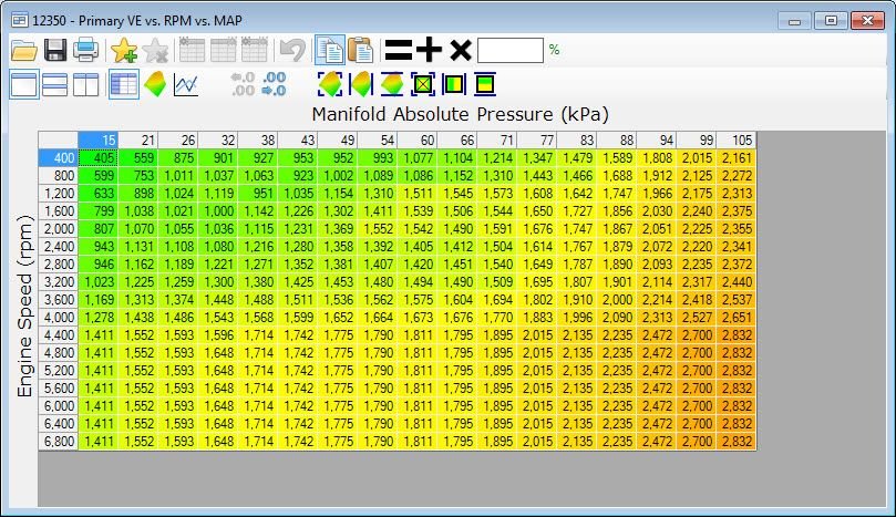

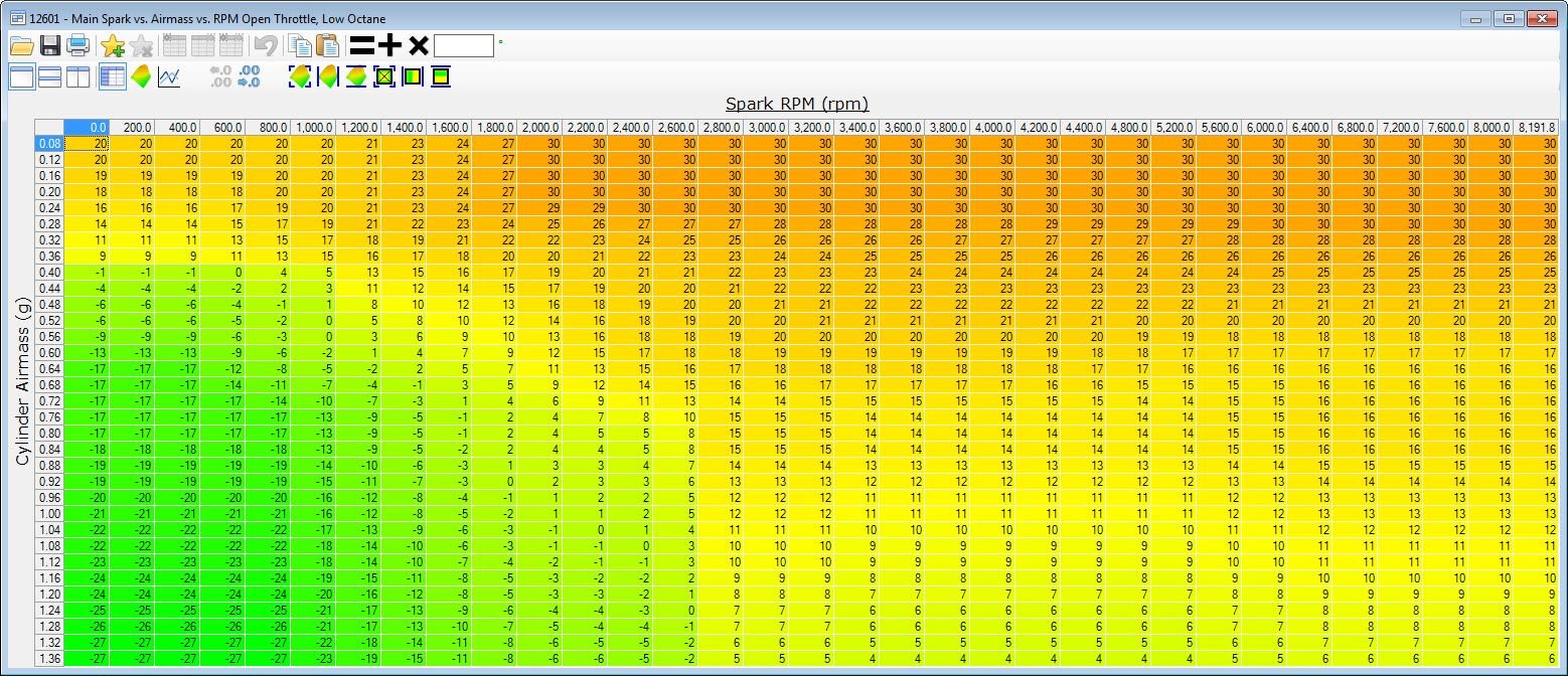

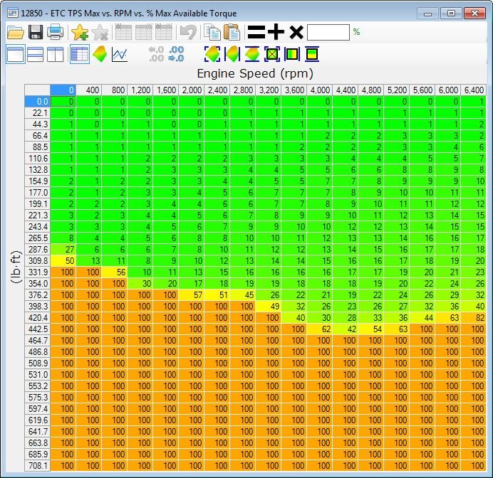

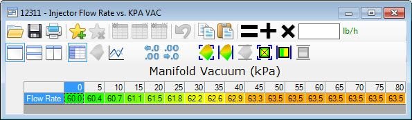

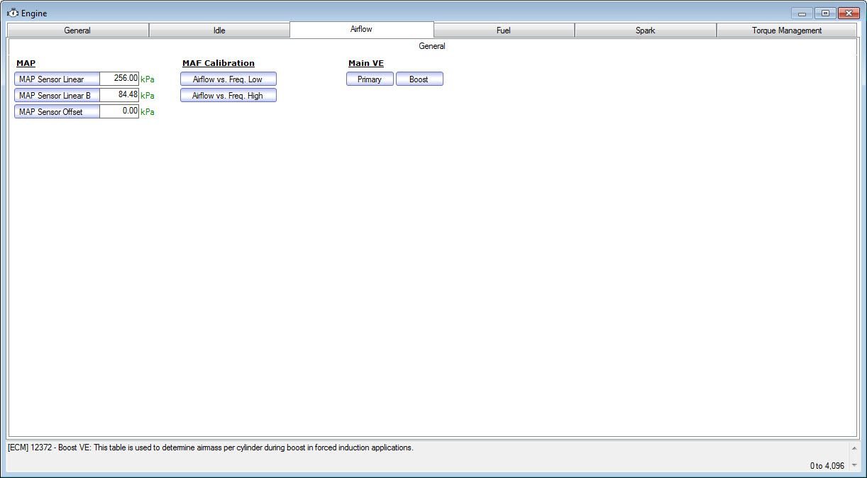

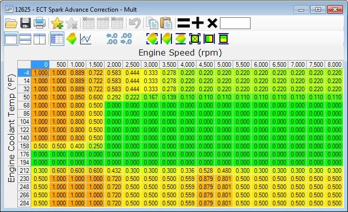

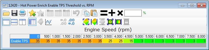

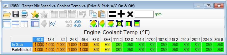

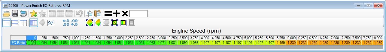

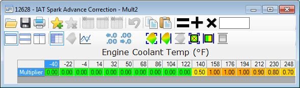

For the individuals interested in looking at the tune/maps or want to follow along to learn, I will post what I have in just minute.
Old Feb 16, 2016 | 06:42 PM
  #91
Spoolin8's Avatar
Spoolin8
Joined: May 2010
Posts: 277
From: MO
Sorry but they are not in order.
