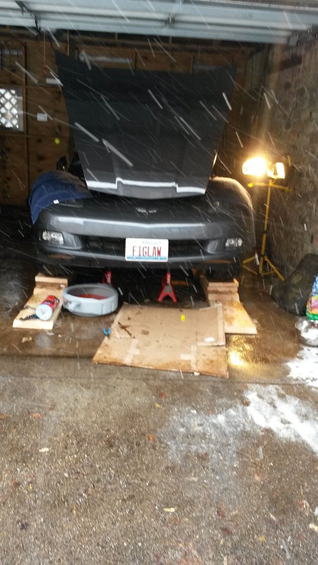

I replaced mine from the bottom on jack stands. I separated the fan from the radiator on removal. Before you install the Dewitt's, fit your factory fan, you may have to drill a hole in the plastic. I installed the Dewitt's radiator and fan separately. Manipulating the condenser is a pain, but the job can be done without releasing the refrigerant and removing the condenser. Get a spare brass t fitting for the hoses at the top (recent thread on this item with Amazon links), you may find that your plastic fitting breaks during the radiator install. I also replaced the petcock on the radiator with a brass plug.
If you are discarding the factory radiator then break the tab holding the condenser to the radiator. I think it's the one on the passenger side bottom that is the problem. Grab it with a pair of channel locks and twist.

Seems that I am in the minority. Removing and replacing the radiator and fan from the bottom on jack stands was not tough and the radiator support did not have to be removed. Did it twice this way and given the need, would probably do it this way again.

I separated the radiator hoses, the upper radiator support, condenser from the radiator, dropped the fan and then lift radiator up to free the two pegs on the bottom the radiator support, tilt lower portion of radiator towards rear of car and lower radiator. Plenty of clearance on the bottom to do this perhaps even with the fan attached. I did this the first time in zero degree weather in the garage on jack stands.
