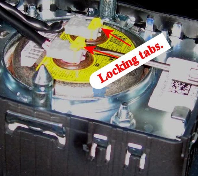

There is a fuse for air bags.
SDM/AOS
Sensing and Diagnostic Module, Automatic Occupant Sensing Module Fuse 10 A - in passenger footwell.
Many owners who have intermittent air bag alarms caused by the seat connector, is to tie wrap the yellow connector under the seat so it stays tightly connected, when the seat moves.
If the air bag connector under the seat (Yellow Connector) is tight, then the only other thing to check is
the little yellow locking tabs for the steering wheel air bag module connectors.
When you removed the air bag from the steering wheel, those locking tabs may of moved a bit and are not sitting down fully.
If those plastic locking tabs are not pushed in all the way down, to lock in the connectors, it will bring up an air bag alarm that will not clear until those tabs make contact with the module.
The color of your locking tabs may be light brown, but here is a pic of what to look for (yellow locking tabs) in this case (2006).
BINGO we have a winner. One of the locking clips was loose and I guess when I removed the air bag it was enough to make it lose the connection.

The clips (tabs) I showed in the pic was from the steering wheel air bag that locks in the connector.
I think I know which ones you are referring to under the seat. The two little blue stab clips for the yellow connector?
