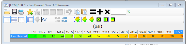

Originally Posted by enventr
Thanks all. I will use a lower stat. This car is not a DD. I do not have to reprogram the fans because the A/C is almost always on. With the stock setup in traffic ,a/c on it hit almost 220 at a light. Too warm for me. I will change the coolent and stat soon. That should be an improvement. The radiator looks like it would be difficult to replace. Does the condenser have to be removed to replace the radiator ? The C4 to me was easier to replace. Hopefully I won't have to replace it.
Although I can't find a table of AC pressures that relate to cooling fan speeds, the cooling fan operates on the higher values of either the AC pressure or the ECT (engine coolant temperature). Assuming you are at that stop light and the AC pressure is only commanding the fan to 20%, which may be it's lowest setting, then the ECT will have to reach 203* just to increase the fan to 23%. So if the AC pressure, due to ambiant air temps and humidity, never commands as much as 50%, then ECT must reach 217* to be the higher value.
The bottom line is that you can't expect the AC values to control the ECT, since they will almost always be less than the stock fan settings. Reprogramming the fans to lower values will assure they will force the fans on at lower ECT.

AC pressure vs. fan %. Highest between this and fan % from coolant temp wins.
Thanks. I knew I'd seen that someplace, but totally forgot it was HP Tuners. The service manual only gives the high and low limits.
