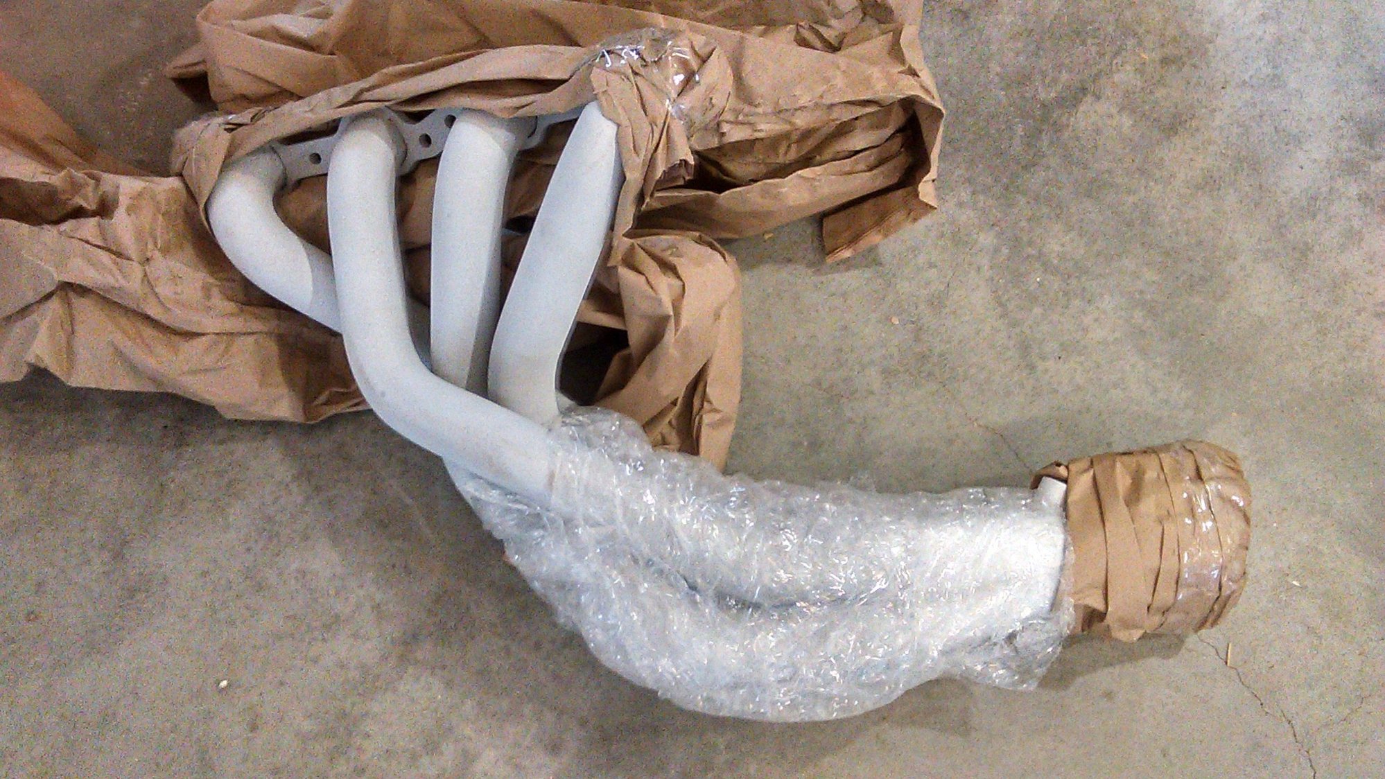

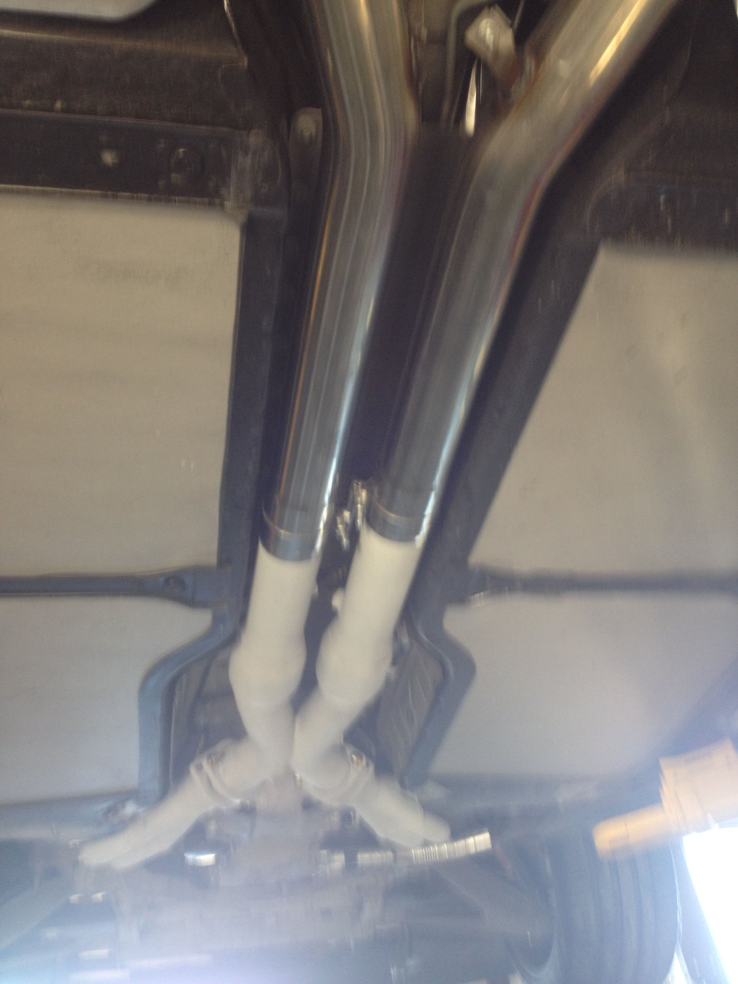

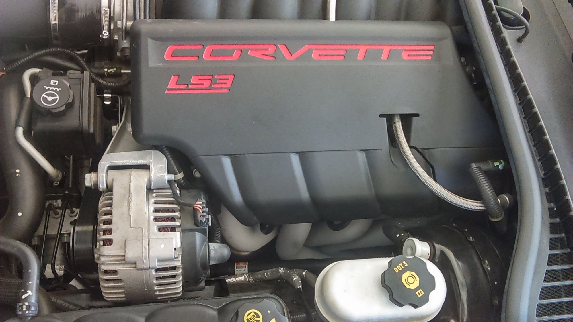

I have a 2013 Grand Sport. I live in Texas too. I bought American Racing Headers, they are Ceramic coated w/the catted X-pipe (1 7/8" w/a 3" catted X-pipe). I bought the full 3" catted X because I also bought Zo6 sized mufflers. I don't regret getting the catted X-pipe. If money is not a big concern, American Racing Headers is the route to go. The ARH headers are a bit more pricey than their Chinese impersonators but they are top quality. If you talk w/the guys at ARH, they will have them Ceramic Coated before they get shipped to you. I had the Headers & the X-pipe coated. It's a plus for Texas Summer & avoiding of additional heat under the hood & right leg area. The coating is from a Company called Swain Tech & the coating is called 'White Lightning. It's a thick heat barrier type coating that is top notch quality. I'd buy them again.

Originally Posted by schpenxel
That coating looks awesome
Thank you. They look pretty sharp under the hood & match my car's paint. The color/finish of the coating hasn't changed a bit since the first start up w/the headers installed. They look much better in person than they do in photos.

I am getting my Kooks 1 7/8 headers coated with white lightening.I am also doing the catted xpipe but been told not to coat the cats.Does the swain coating reduce the heat in the tunnel area?Have you had problems with your cats?

I don't know why people would say to not coat the cats...I noticed a significant drop in the heat from the tunnel area compared to when it had the stock manifolds & cats. I sold the car a while back & had it like that over a year. I never experienced any problems whatsoever while I had it. I live in Central Texas so the main reason I had the cats coated as well as the headers was to try to reduce the tunnel heat. FYI- The heat wasn't gone altogether but definitely reduced, no question.

Kooks said DO NOT coat cats as they would not warranty the xpipe if I did.They said the cats need to be able to through off heat or they will degrade quickly.

I noticed that you only coated the section closest to the header.

Hi Fitz. Warranties are useful I guess...I coated the entire X-pipe piece. On the ARH x-pipe, the X-pipe & cats piece is pretty short. (The X on the X-pipe is before the cats) That is the size of the entire X-pipe. The rest of the 3"pipe is a seperate piece for ARH.
