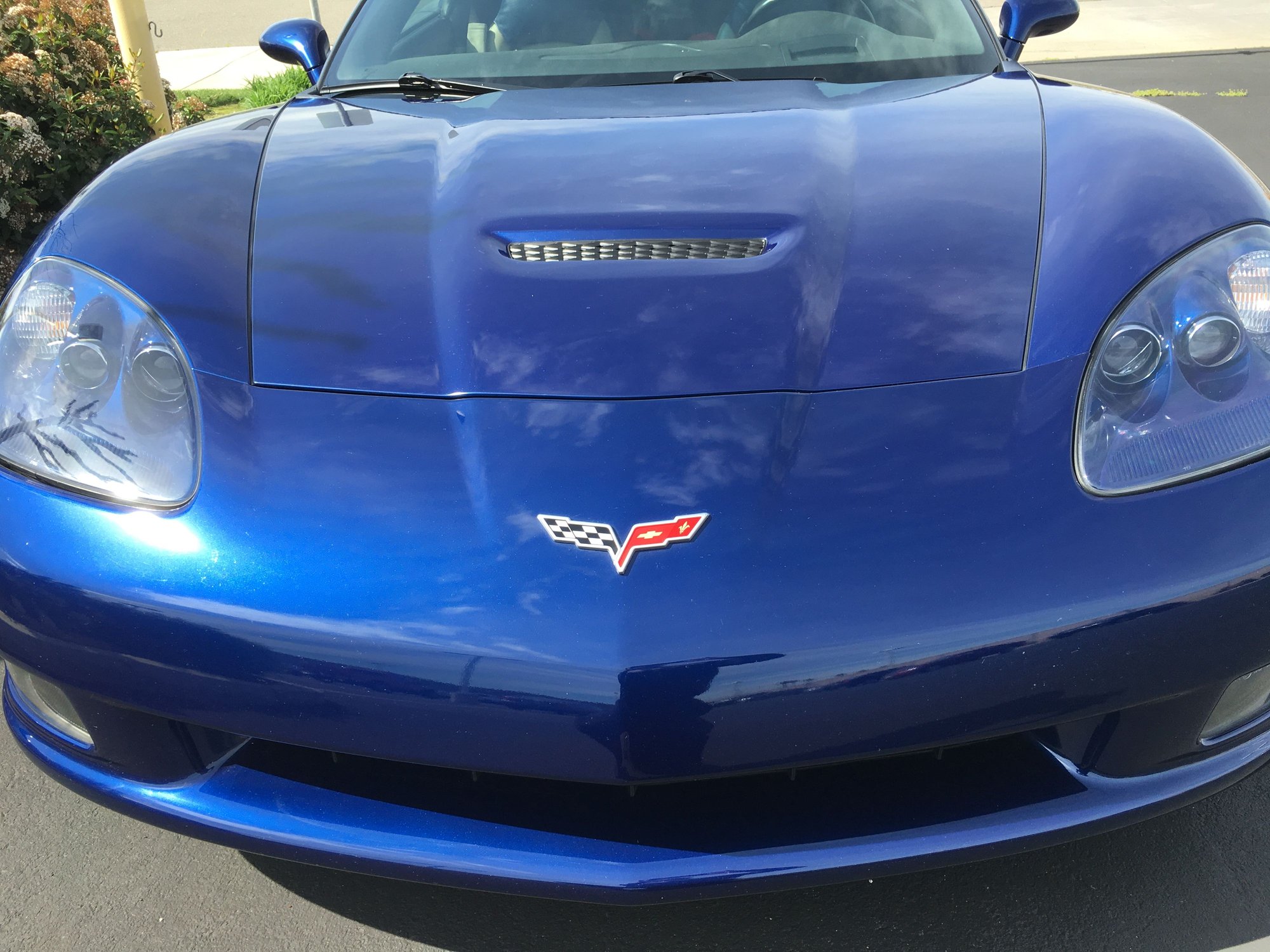

is that a photoshop or some after market hood?
never saw a vent like that

I had that hood custom made no one has it. It's real and it was not cheap to do. i ask the guy to make it look factory and he did. It took a lot of work to get it right but it came out clean. Many people have said it looks very good. I wanted something no one had. Believe me it's real for sure.
