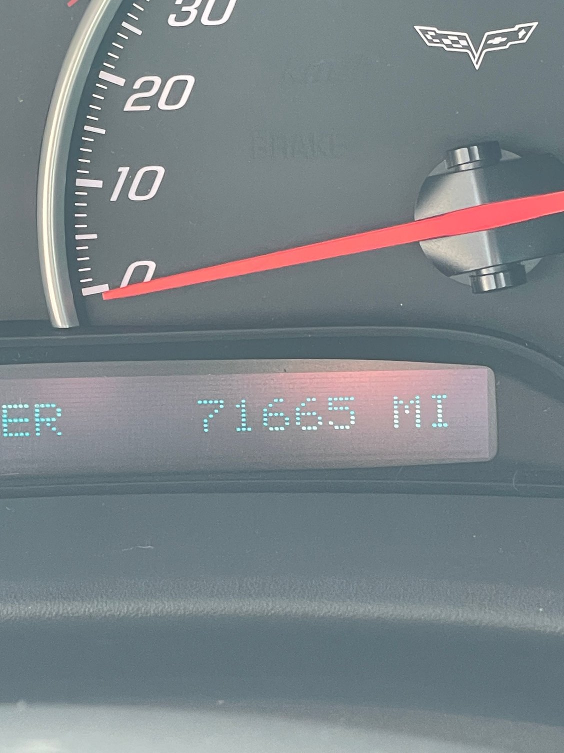

Old May 30, 2026 | 08:50 PM
C6SEUSA's Avatar
C6SEUSA
Joined: Jun 2021
Posts: 504
Likes: 42
From: SW Florida
Instrument cluster replaced with used cluster and programmed to match my correct mileage.
How was the programming done? Future owner with possible issues might want to know this info.
Old May 31, 2026 | 11:02 AM
C6SEUSA's Avatar
C6SEUSA
Joined: Jun 2021
Posts: 504
Likes: 42
From: SW Florida
It was done by a company that uses software to adjust the mileage reading. The cluster was sent to them and they made the adjustment. In case you are not aware, the C6 instrument cluster has no VIN number programmed into it and the only thing adjustable is the odometer and is only done when replacement is needed.
