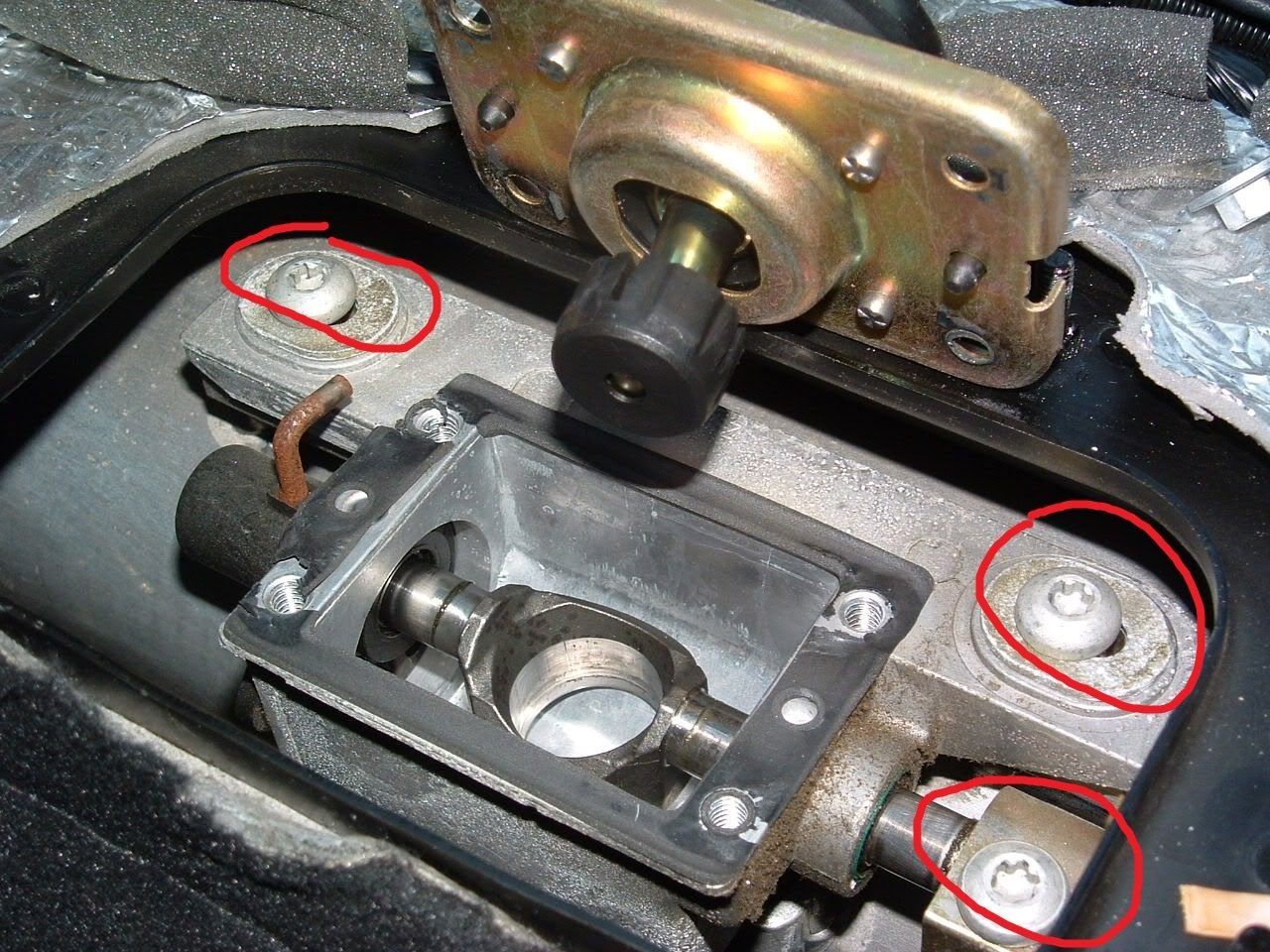

Anyone know the part number to these shifter housing bolt. I have a C6Z FYI.

But since they are just a TORX t45 socket head ,M8X1.25X27 bolt, might be faster to just hit a local hardware fastener store and pick some M8X1.25X27 up with an allen head cap bolt instead.
Hell, home depot sells them for like $2 for a bag of two,

I had original manifold bolts laying around and used those last time i was in there. I hate those damn torx. Thought I was working on a volkswagen for a minute.
