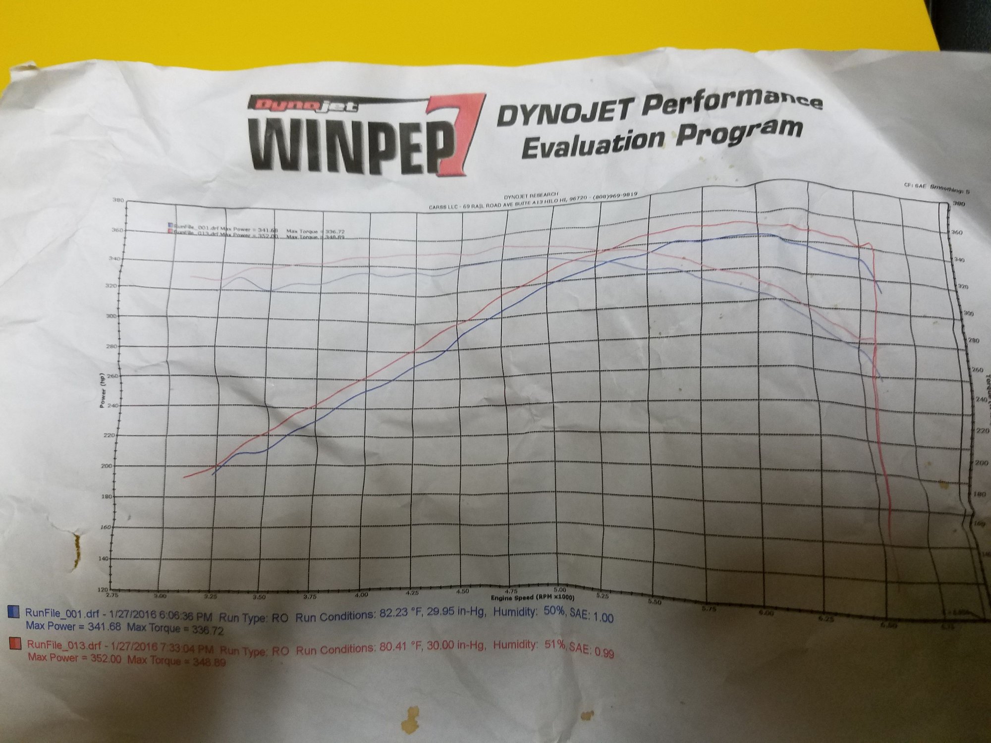

Found my dyno sheet when i was sad it was low numbers with all the lt high flow cats exhaust and cia and intune 2

If I squint real hard it looks good to me.

for a stock LS2 automatic with those mods those are good#'s need to send a "run file" to intune and let them touch it up. My 06 MN6 bone stock was 346HP with a U794 Diablo sport 93 octane tune on 91 379 HP but had a bad knock around 4000rpm, then they came out with a 91 octane tune by then I found out the many benefits of a tune done by someone who really knows what their doing, my 06 now, full Z06 exhaust, roller rockers, CAI, baby cam, 401 RWHP 399 TQ and it comes in very low around 1000 rpms and just pulls right to redline. did you think GM didn't know what they were doing and your highflow cats, and CAI, canned tune where going to give you 100 HP?
