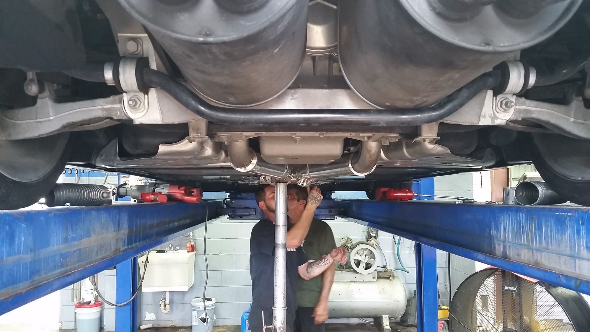

Hello all, so I picked up a C6 Corvette project, and I'm wondering what the heck is missing from the rear suspension? The car came like this, and I'm wondering if this is a labor intensive part or one I can replace in my driveway. Thanks all!

If it's unclear I am referring to the missing top bolts on both sides.

The rear sway bar is missing. To determine the correct one the factory installed, look on the inner glovebox lid to find a 3 character code the begins with FE and a number. You may also consider a slightly stiffer sway bar if you intend to do anything beyond cruising.
You'll also need the bushings, clamps, bolts, and end links.
Yes, it's easy to replace in a solid driveway, but not the one in your photo.

If you are in southern California, I have a FE1 rear bar with bushings you can have, this is from the base suspension. I may have the brackets also. I do not have the bolts or end links.
Reply here or send me a PM if you are interested.

Thanks for the responses everyone! The sticker appears to be missing, but I know that the car is a Z51. Would it be possible to use the base sway bar? (Or a cheaper alternative, since I don't plan to track my car or drive it hard?)

Yes, all c5/c6 sway bars are interchangable. zr1, z06, z51, etc etc.
It's possible to drive the car with no sway bars, but you'd get more than normal body roll.
I'm surprised the glovebox sticker is missing, which probably means the whole door was replaced. That also makes me wonder what other things on the car convince you that it has the Z51 option?

If you are happy with the way it drives you can leave it alone.
New base model c7s don't have a rear sway bar. They removed it yet the z51 and "performance" models add a rear sway bar.
