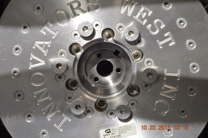

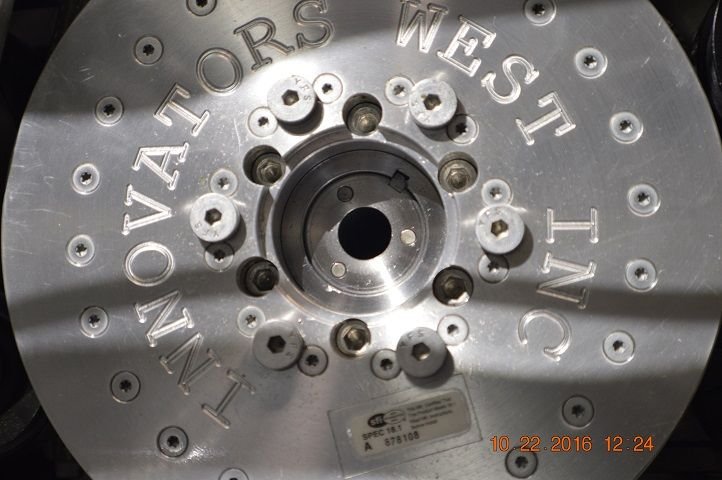

I probably have the wrong one, regardless this one is solid and ain't going nowhere.
Crank stout adapter in, light hand press fit:
Pinned. 12 minutes. Best $70 I ever spend. Well there was that one hooker in Vegas, so this is definatley in the top 3
YAY.. It's blower time.
