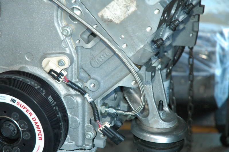

Drill and tap.

Shouldn't the ECS kit come with 2 lines? And not just the return line? or do i have the feed line i do not know.. i just know i am missing parts
Think I'm going to do the return hole on the pass side. Easier to get to. As for the feed line holy hell idk how to get to that lol.
