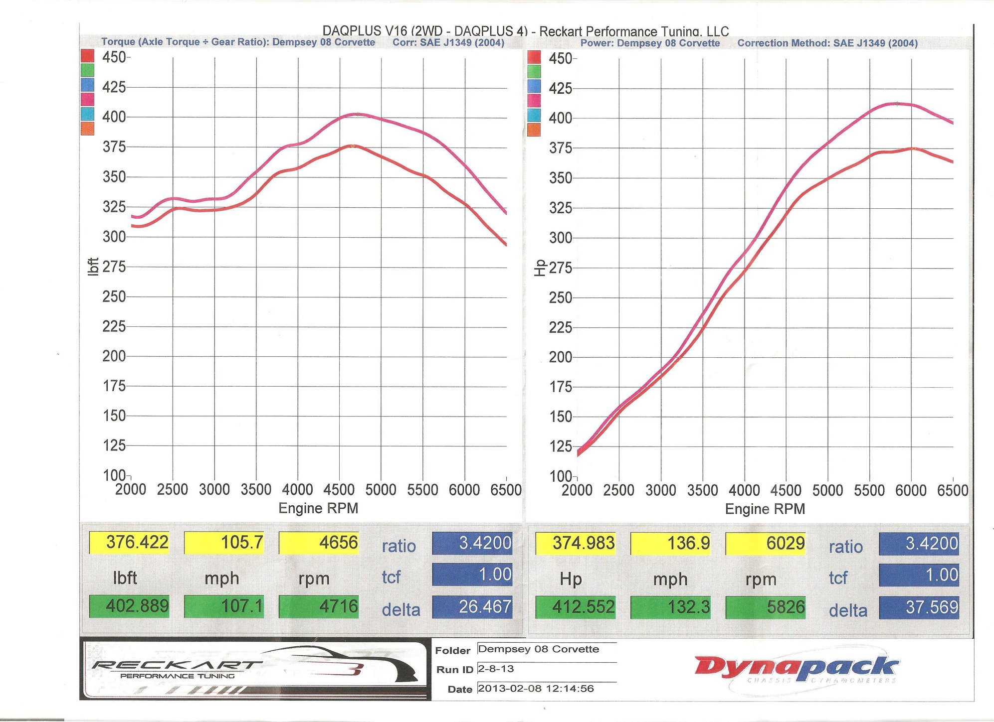

I would say get the X-pipe that matches the Headers. I owned a 2008 Coupe that I had Kooks 1 7/8" Longtubes installed on. I used the Kooks catted X-pipe into Corsa Xtreme mufflers. Here's a video of some idle & revs-
. With these mods, the rear O2 sensors were deleted & bolted closed & it was wide band tuned w/a Halltech CAI. If you want some more info on what I did with this specific build I can let you know.

Following this thread and wondering for those who have added headers, and tune, what was the performance gain afterwards? 30HP, 40HP? Could you actually feel the difference driving it, or was it just your mind telling you its quicker after you dropped a few grand?
Have an '09 with LS3 and Airaid intake. Ordered ported throttle body and know headers and tune are the next step so looking for real world results and experiences.

I can assure you that you can feel the gain in power and its not its not all in your mind .
I did not have mine dynotuned but the boards are full of people who did and report 30 to 40 hp gain
