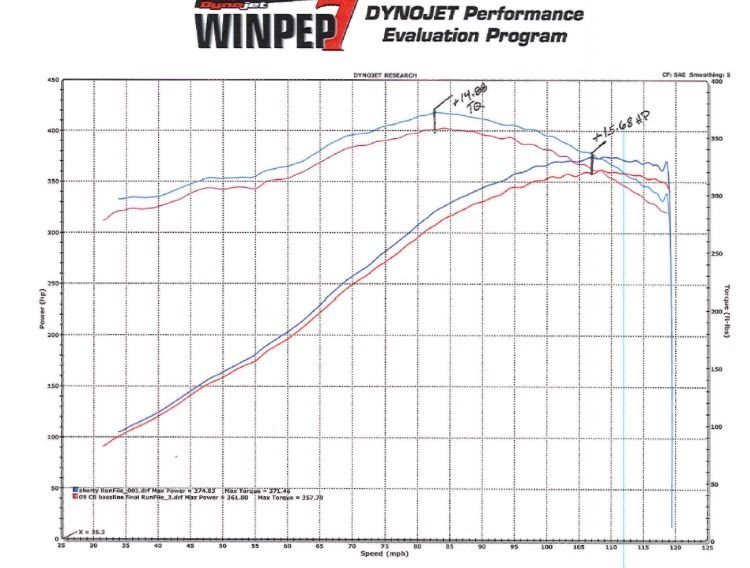

i've had BOTH. Didn't install the magnaflow because the quality was so bad, terrible looking welds, scratched ceramic coating etc. Decided to sell and purchase Hooker, much better quality construction and hooker had a merge collector inside that magnafliw didn't. Installed and had a noticeable change. Hooker will also provided the dyno below Don't make the mistake I made with magnaflow . And yes, contrary to what longtube guys often claim there is a notcabke improvement with shorties. Just less as you'd expect

i was surprised too. I thought magnafliws would be good quality. But the difference between them and hookers was significant. And the complete lack of inner velocity spike where tubes come together on magnaflow versus the presence of one on the hooker makes me believe the hooker will perform better as well as last longer. Hooker 304SS too, versus magnaflow mild SS that's poorly coated.
Hi 08, when you received our headers, did you contact our customer support? It is very uncommon to hear of issues like the ones you described, but we would have been happy to replace them with an entire new set under our lifetime warranty. We stand behind our quality 100% and do our best to address any concerns our customers may have with new product.
We design certain header applications with a velocity spike, however it did not produce any additional power benefits on the stock C6 tuning, and added additional cost to the product, so it was not used in our final design.
