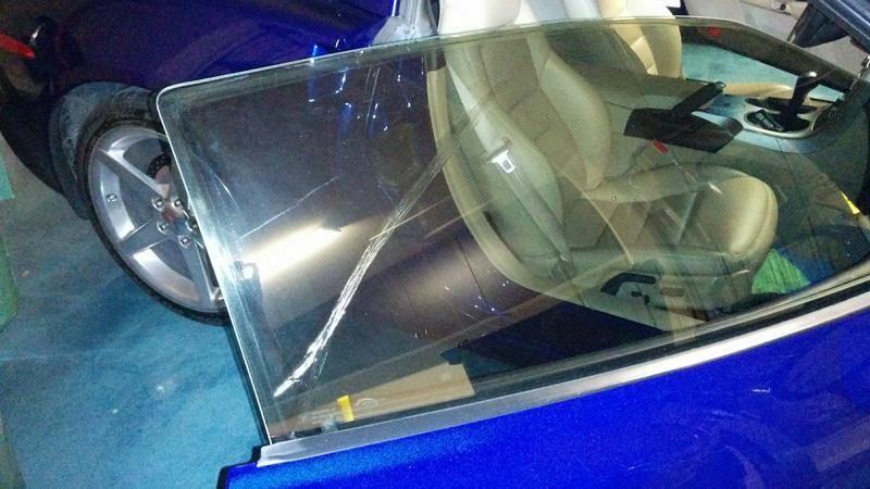

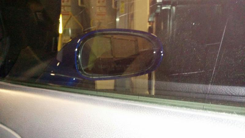

I had my '05 tinted shortly after getting the car that summer. After a few years, I noticed the passenger side window started developing lines or streaks down the tint.
After a few more years, a crease started to form because the top layer of the tint was being pulled down.
Finally in 2013, I attempted to have the tint replaced, but the installer said he wouldn't do it since there was a problem with the door and it would just do it again.
I attempted to take the door panel off once to take a look but it was pretty stubborn and I didn't really want to break any clips to just take a look.
Well now it is finally time to sell my car, and I need to do something about the tint. I may just remove it, but I was wondering if anyone else has seen this problem and knows what I need to adjust in the door if I actually take it apart.

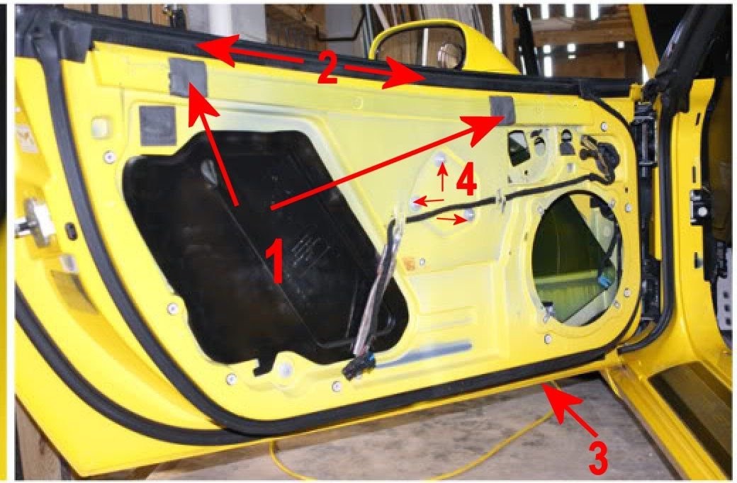

The window runs up and down on soft velcro type material on the window track to prevent scratching. It's possible that there is dirt on the strips causing the scratching. The window can be tilted inward or outward using the adjusting bolts to reduce the amount of force on those strips of soft velcro material.
The window track (#2) is the upper most trim piece, which can be removed once the door panel is removed.
