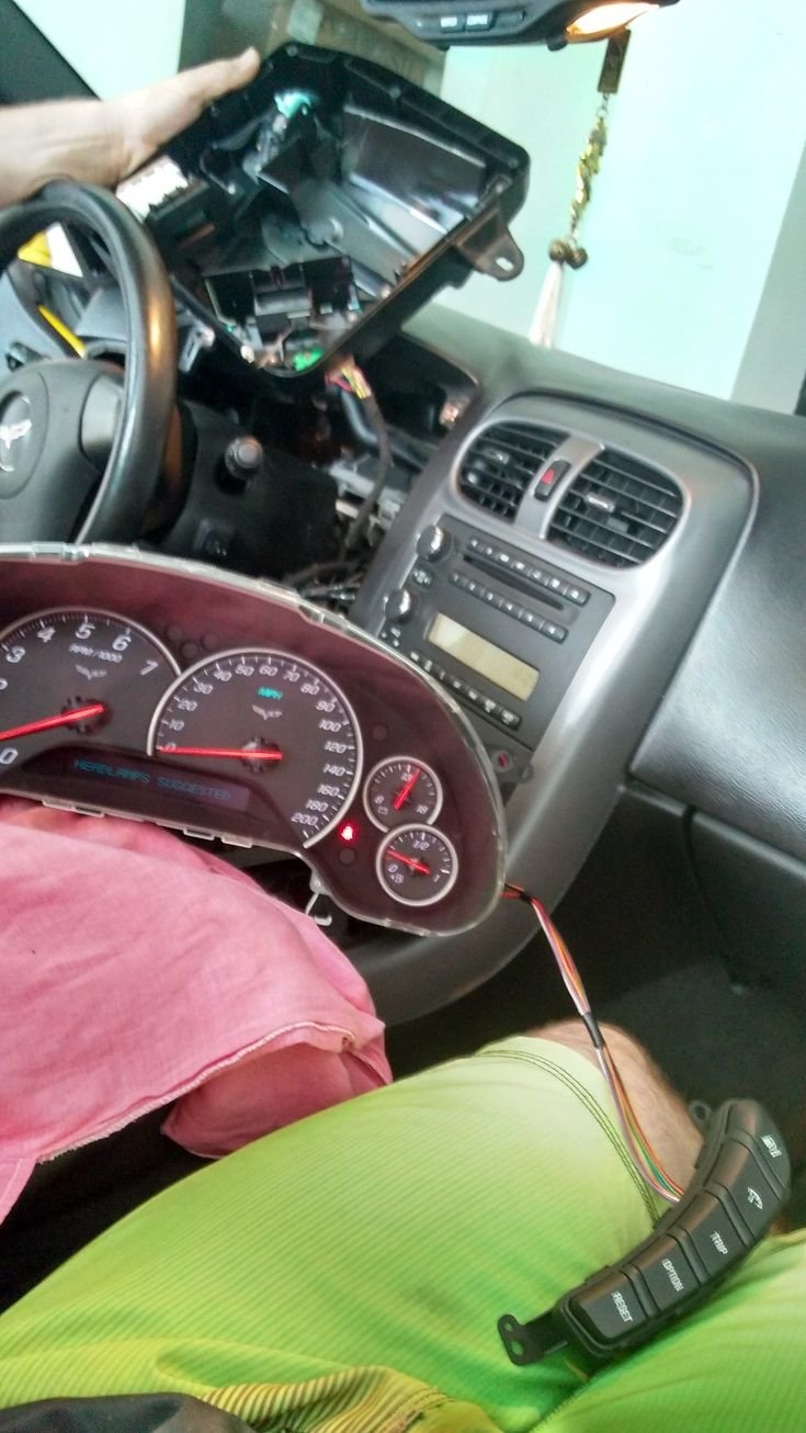

Hello everyone!

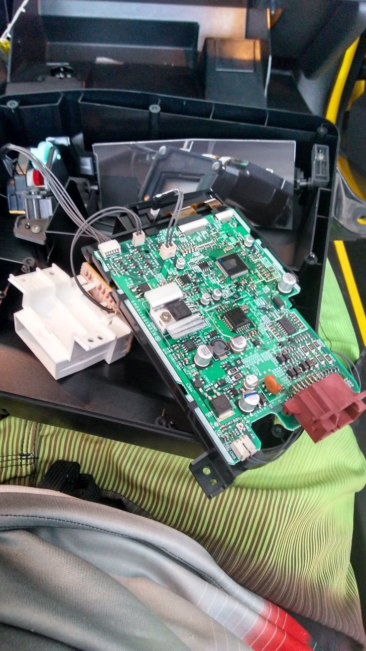

Here's what happens: The HUD of my 06' Base Convertible Vette never worked since I bought it (aprox. 7 months ago) and I decided to take the car to a guy who is specialized on car electronics (this guy already fixed a circuit fail on my Vette's power window once, so I really trust him) to unmount the dashboard and try to find out where the problem is.
After unmounting the HUD and testing the PCB, he found out that the problem is in one processor oscillator that is oxidized and not getting any power, so the HUD doesn't work at all. Since it's nearly impossible to find the electronic scheme for the PCB to try and fix it, I decided that I need a new HUD.
The problem is that the C6's have two HUD part numbers: 15934351 and 10392152 (mine is the last one). It seems that the 2152's are more rare and expensive than the 4351's. I already sent a message to CULTRAG performance about it and I'm waiting for his response. Does anyone knows if there is any difference between those PNs? I believe that is only aesthetic differences on the projection, since I saw different HUD layouts for the C6s on the Internet, so I'm pretty sure they're compatible between each other, but who knows? hahaha
I'm also posting some pics of the service and of my car so u can also enjoy. Any help would be greatly appreciated. My best regards for everybody on the community!
Unmounting
Testing
The HUD already disassembled
