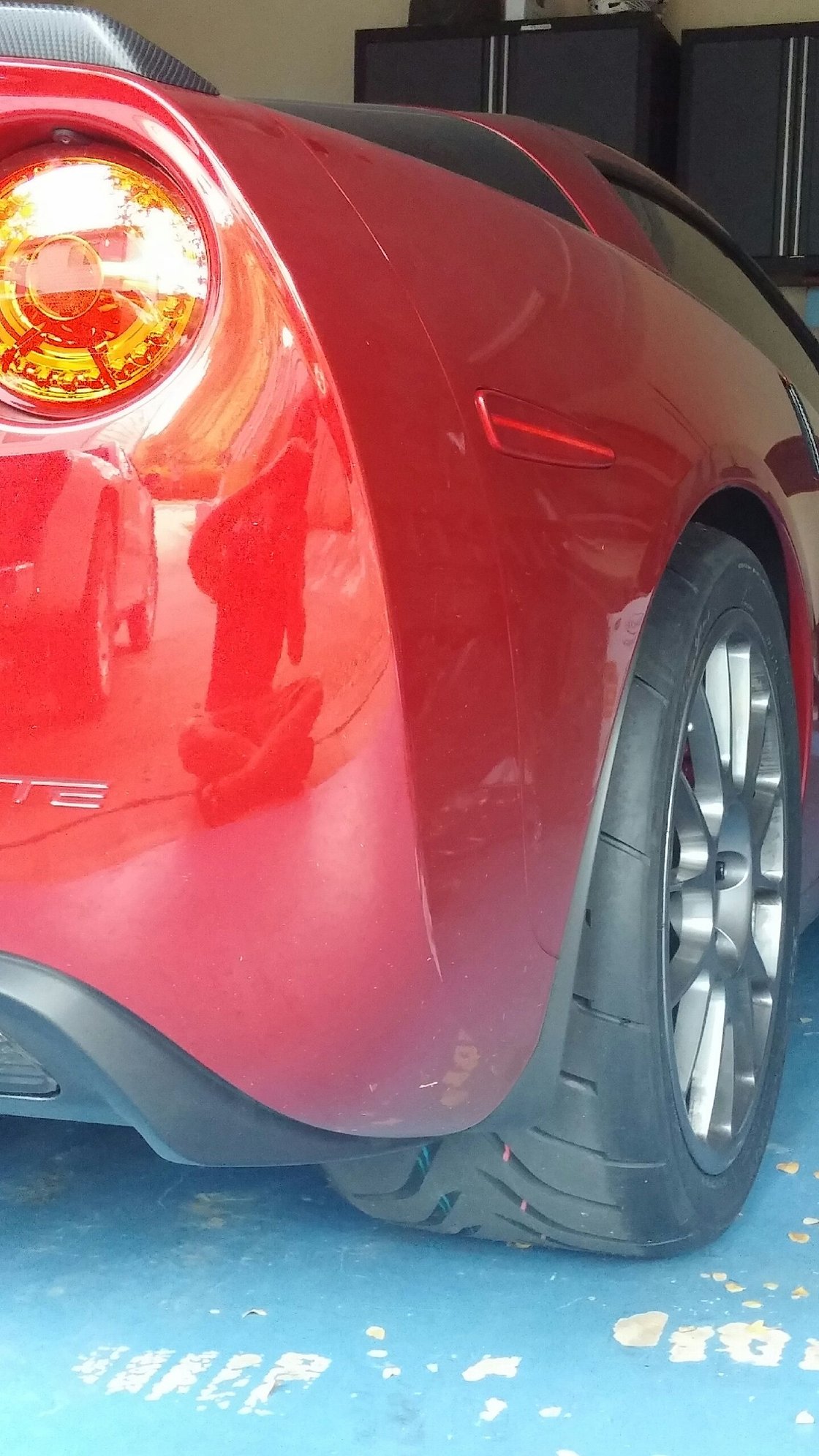

I have a WIDE R888 345/30x19 tire on a 19x12 with 10.5" backspacing on an '08 base, but it's on a Lingenfelter mini-tub. However, upper A arm clearance isn't the limiting factor. Also, my rear wheels are inset too much w/ the -1.3 camber I run, if I had my druthers the offset would move them out about a 1/4" (6 mm) to be ideal.
