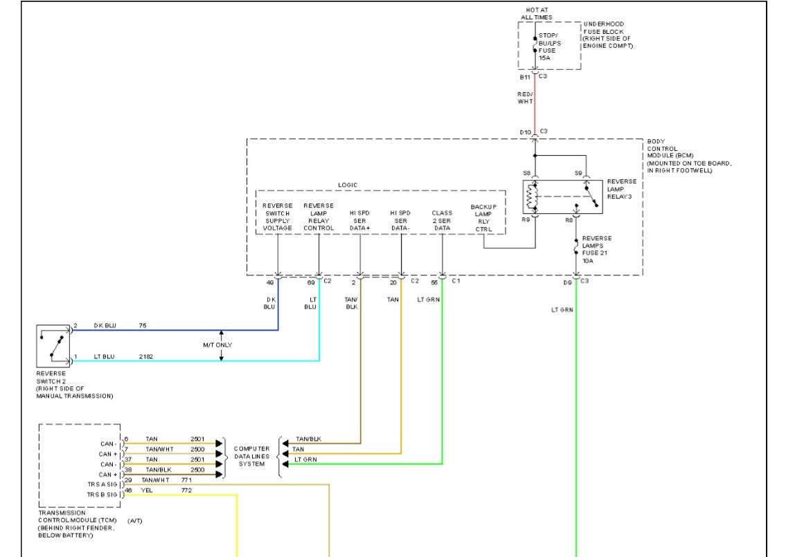

Here is a wiring diagram of a 2005 C6 Manual transmission.
It may help

Reverse light circuit for 2005 C6
