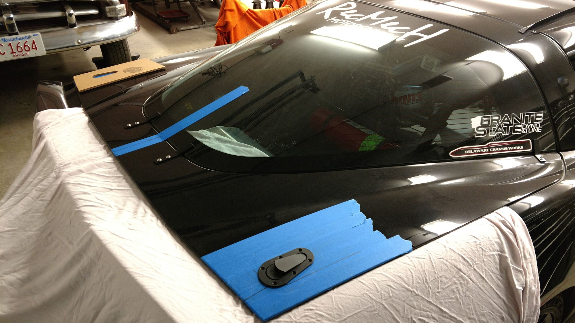

I am actually working on this right now.. I ordered a spare latch assy and cables to experiment.
So far I have a passengers inside lever mounted by my right hip on the tunnel.. Makes it much easier to open with a full door net (net always seemed to fall over the latch when in a hurry). I am also relocating the door button and window switches to the center console for the same reasons.
I am now working with the latch to come up with a manual pushbutton or pull assembly that will reside in the recess outside the door. Will keep you posted.
Last year I just added a decal to the rear hatch "door release inside" and a "pull to eject" yellow tag on the pull cord itself. Showed the safety crew where it was.
I have also removed the rear hatch electronics in favor of manual..
