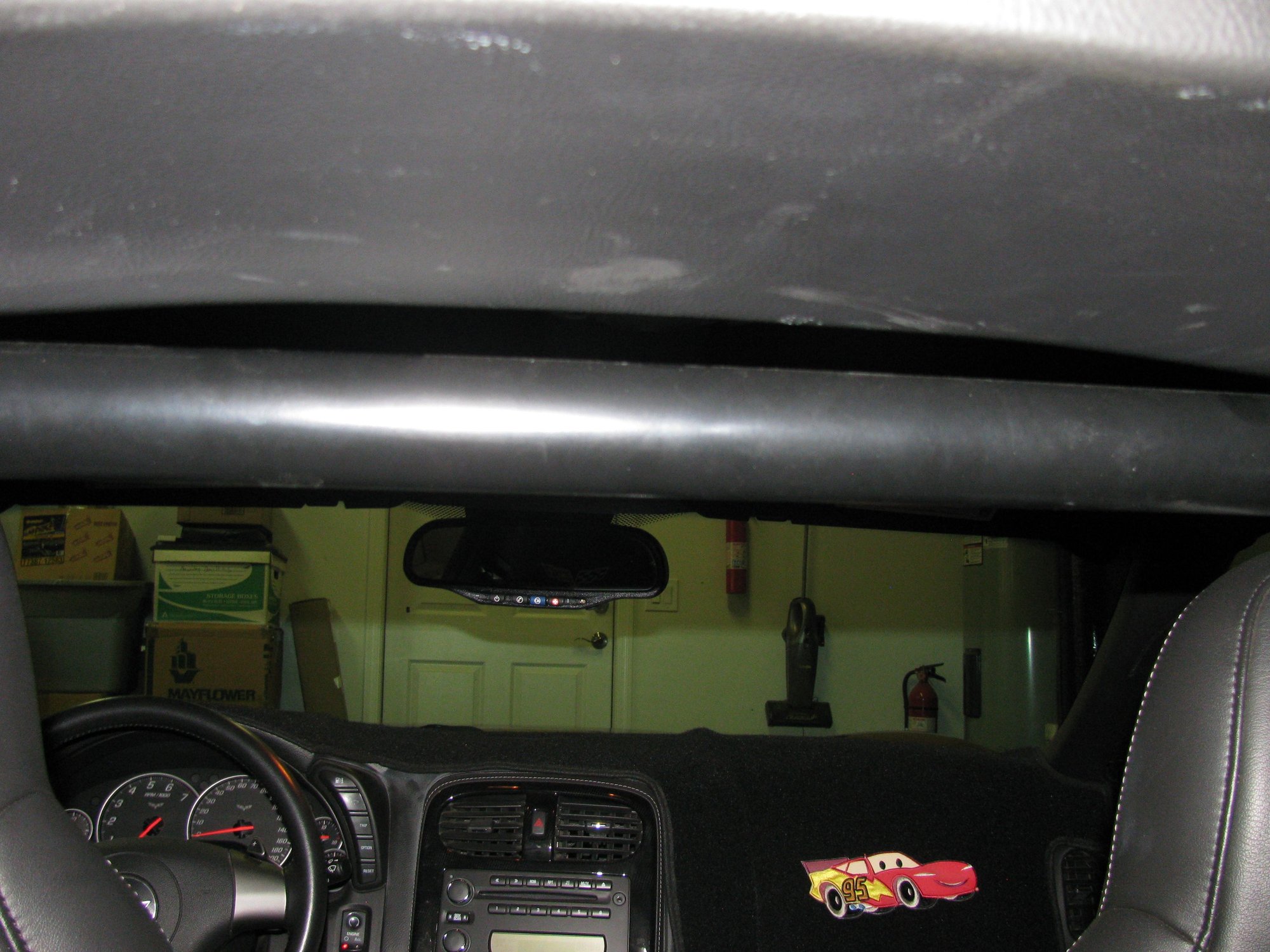

Getting ready to pull the trigger on an RPM 5pt bar, install looks pretty easy but have a few questions.
Going with the removable door brace and also thinking about doing a removable passenger side to bring it to 6pt thinking it will also stiffen up the car better and I'm ripping out the interior anyway... Anything wrong with this thinking?
Also thinking of going with the rear brace for additional safety. Can't find detailed docs on the install for this but it looks like it simply bolts to the top of the rear frame rails. Are spacers needed to mount to the frame?... and does using the rear brace get me legal under 9.99 or 10.0 still the min ET?
Final question is how is the quality of the "standard" flat black finish? I don't need carbon dipped coatings or skulls and crossbones on the finish, but still want the cage to look good and just blend into the black interior of the car

I installed a chrome moly 6 point RPM bar in my 09 base car just over a year ago. I went with swing outs on both doors which makes getting in and out of the car really easy and if you don't need the bars just take them out. I had help installing mine and the extra pair of hands came in handy! The only things I really had to take out of the car to install was the seats and pulling back some of the carpets. I re-padded the bottom of the drivers seat while the seats were out.
Your going to need more then the rear brace to make the car 9.99 or faster legal. I'm not quite sure what the rules are now but a couple years ago I had a chassis guy tell me what it would take and its pretty extensive. My car is a high 9 low 10 second car and I run several tracks here in the south that are pretty picky on the rules and so far once they see I have a 6 point in the car along with a 5 point harness with good dates I'm good to go. I have seen them tell guys running 10.90's are quicker to slow down or go home without any kind of bar in their cars.
I have the standard black finish on mine and after a year in the car still looks like new. A few scuffs on the drivers door bar from me getting in and out but other then that all good.

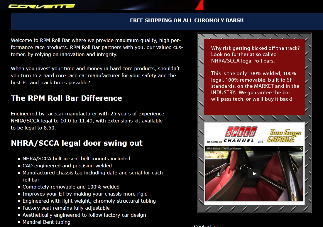

Seriously, you bring up something new to me that bolt-ons aren't legal. From what I understand RPM rollbars (proposed vendor) are NHRA legal, even the bolt ins, and guaranteed to pass tech or they refund your money. The 5pt has a guarantee to pass 10.0 and I'll be going 6pt with the rear brace so calling that good enough.
Not that I fall for sales babble...but it's in plain writing on their site
From the RPM website:

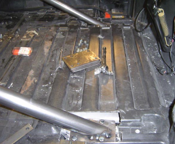

The rules are very clear that a rollbar must be welded or bolted to the frame. The key word here is frame. Neither the thin sheet channel fuel crossover cover or the composite/balsa floor are the frame.
http://promod.nhra.com/userfiles/fil...en.%20Regs.pdf See page 21 & 28
If you want to buy, install, get rejected, un-install, and return for a refund, that's your choice. Talk to the NHRA chassis guy and show him the pics and install instructions.

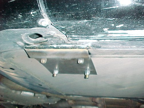

Looks like you saved me a bunch of money here because aluminum plates are needed, welded to the frame to bolt the pads, not bolt the pads to the floorboard. The only reason I was going with that setup was because of the "legal" NHRA claim and willing to pay a premium for that, but that turns out to be bullshit anyway....and like you said, sure they will "buy it back" after I rip it out and pay to ship it back to them.

No bolt in bar is legal without welding plates to frame that extend out to attach it too. Rule book shows type and thickness of plates that need to be welded to frame for the bar to attach too.

My interpretation of page 20 is you can bolt directly to the aluminum frame on vettes... key word is "directly", but that's impossible if you want to have doors on the car so a weld on aluminum plate to the frame is needed. The welded plate doesn't look too bad and the rear points in the trunk can bolt right to the frame easy enough but this is getting crazy. Seriously, all I want to do is run the car for a few test and tunes, maybe hit 9.99 without getting my ***** busted and have some protection so my skull doesn't leave a snail trail down the track if I flip it over. And not get ripped off by someone who bullshits me into paying $2800.

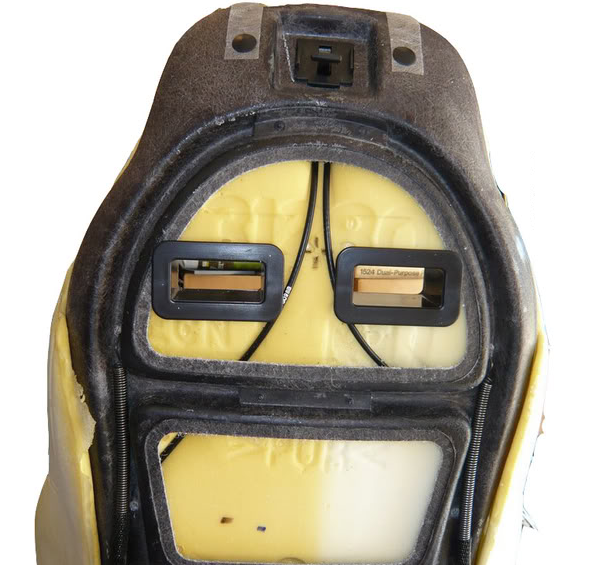

You'll also need a harness, Crow makes a nice 6-point package for Vettes where you can retain your OEM seat. The sub belt can attach with 1/4-20 bolts to the holes on the front of the slider frame where the push pins hold the plastic covers. The lap belt can attach to eyebolts if you drill the holes just inboard of the rear seat mounting studs.
Here's how I modded my OEM seat for the belts. https://www.corvetteforum.com/forums...in-my-car.html
