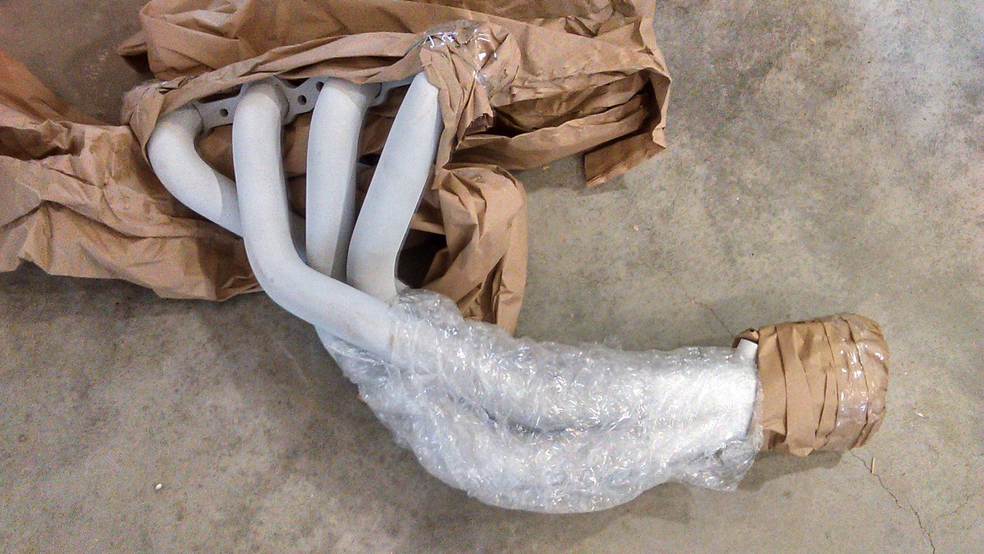

I just got a set of Stainless Works long tubes for my Grand Sport. They fit real nice and I also had them coated so the heat is not so bad. Also had the X pipe they make put on with the headers. Have Corsa sports on the car already..... The sound the car makes now is unholy....... I can't get enough of it....... put a Snow Methanol kit on it also......
