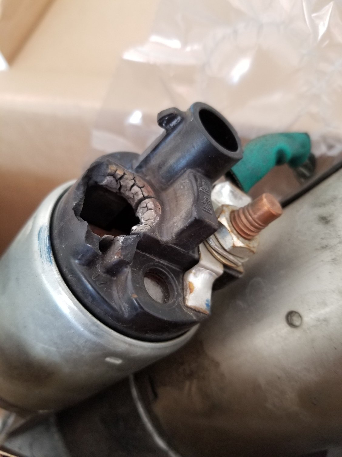

I bet it's the selonoid....just put the starter in and be done with it
Mine did the same thing ... and here is what I found when I dropped the starter 1/2 an hour before i was suppose to leave for the track .... I should have just dropped it as soon as I started having the no start issues ...
and it was not caused by heat from my headers as they were only on a few weeks at the time of failure .... this was caused by my stock exhaust and the Cat that is stuffed right up there between the starter and the frame..
if you don't have headers it will take you no longer than 30 minutes to do if ubare good with tools
Dave
