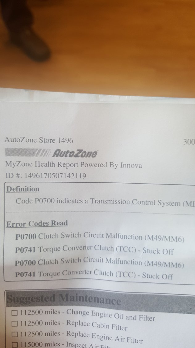

Engine light came on and took it to autozone to check the codes this is what i got car is a 2008 corvette with A6 cam headers 3800 yank stall converter

Most of the time when this happens the converter is slipping from trashed clutches. The cause is typically that the car is still tuned to lockup the converter under WOT.
