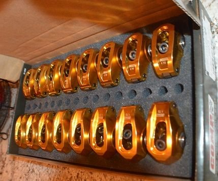

Got my rockers and immediately noticed these suckers are heavy. Most of the weight is centered around the trunion but I might do a comparison between weight at the valve step which is where the damaging inertia comes from. Regardless, they are super nice and going in. Won't bore you with a pic of yet another box of Ultra Golds.
I waiting for the results. And if I come to the conclusion that I need new valvesprings, I'm definitely gonna change the heads.

Ain't they pretty?! Someone really ought to do a clear poly carb valve cover so we can show these gems off.
