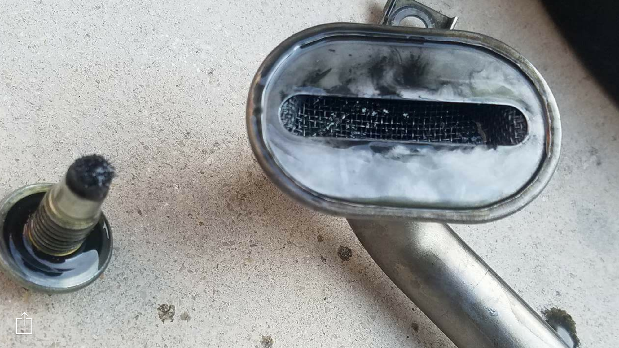

Hows it going, guys!! Ok, so I have a 2008 C6 base. I just had a brand new LQ9 408 stroker built for it and had about 150 miles on it and it lost oil pressure. Luckily I was at a gas station and the warning light came on before I moved it, so I turned the engine off and called the shop that did the work. They came and picked up the car and after looking at it the mechanic stated that the pick up tube in the oil pan was almost stopped up with assembly lube and shavings.........So he cleaned the pick up tube and put it all back together, put oil in it and started the car and still no oil pressure. Now he states that the oil pump is bad. Now he has to replace the oil pump, and is going to charge me labor to do so.
I have multiple concerns here, first; is it normal for a new engine like that to have shaving that could possibly clog the pick up tube? Assembly lube and shavings? Mind you, EVERYTHING in this motor is brand new. All Texas Speed parts (forged internals) and a stage 5 cam, along with LS3 PRC heads. It has a 500 mile break in procedure and I HAVE NOT dogged on it at all. Second; the car has now been started 3 times for about 4 seconds each time with no oil pressure. Should I be worried about engine damage because of this? And third; should I be paying for labor for him to put a new oil pump in the car? He stated that it's not his fault that the oil pump went out, if this is the case, and that he's gonna have to charge me labor, $800.00. All said and done, I have now paid a little over $11k to have this build done. Please let me know what y'all think. The car is still in the shop and I'm wanting some feed back before I pick it up on Saturday. Thanks in advance.

First things first..................... the correct engine assembly lube is compatible with engine oil, and would also dissolve and mix with the engine oil due to normal operating temperatures................
shavings and grease to plug up a pick-up tube indicate possibly incorrect assembly grease which didn't dissolve and mix, but may have "washed off" the components it was initially put on and then gathered in the sump where it may have become "picked up."
The "shavings" are worrisome. It is normal and natural to get some fine particles on a new build, but nowhere near any amount to plug up a tube, unless something drastically was wrong. Shavings typically are from abnormal "metal to metal" contact, and that should be relatively noticeable upon inspection.

Here are some pictures that he sent me of the oil. The care already had a stage 4 cam in it, so there was no need for a tune, at this time. I will be getting it tuned after the 500 miles, though.

All the bearings/etc need to be pulled, and inspected or replaced. You have a major issue and something failed.

Looking at that oil pan, that would freak me out if it was mine. This is far beyond normal.

The metal on the pump screen doesn't look normal.
Debris on magnetic plug doesn't seem ab-normal.
Grease/ assembly lube build up = BS IMO.

What color was the metal in the pan? Everything points to the main bearing. That motor will need a full rebuild to the bottom end either way with that much metal going through it. I would cut open the oil filter also.
