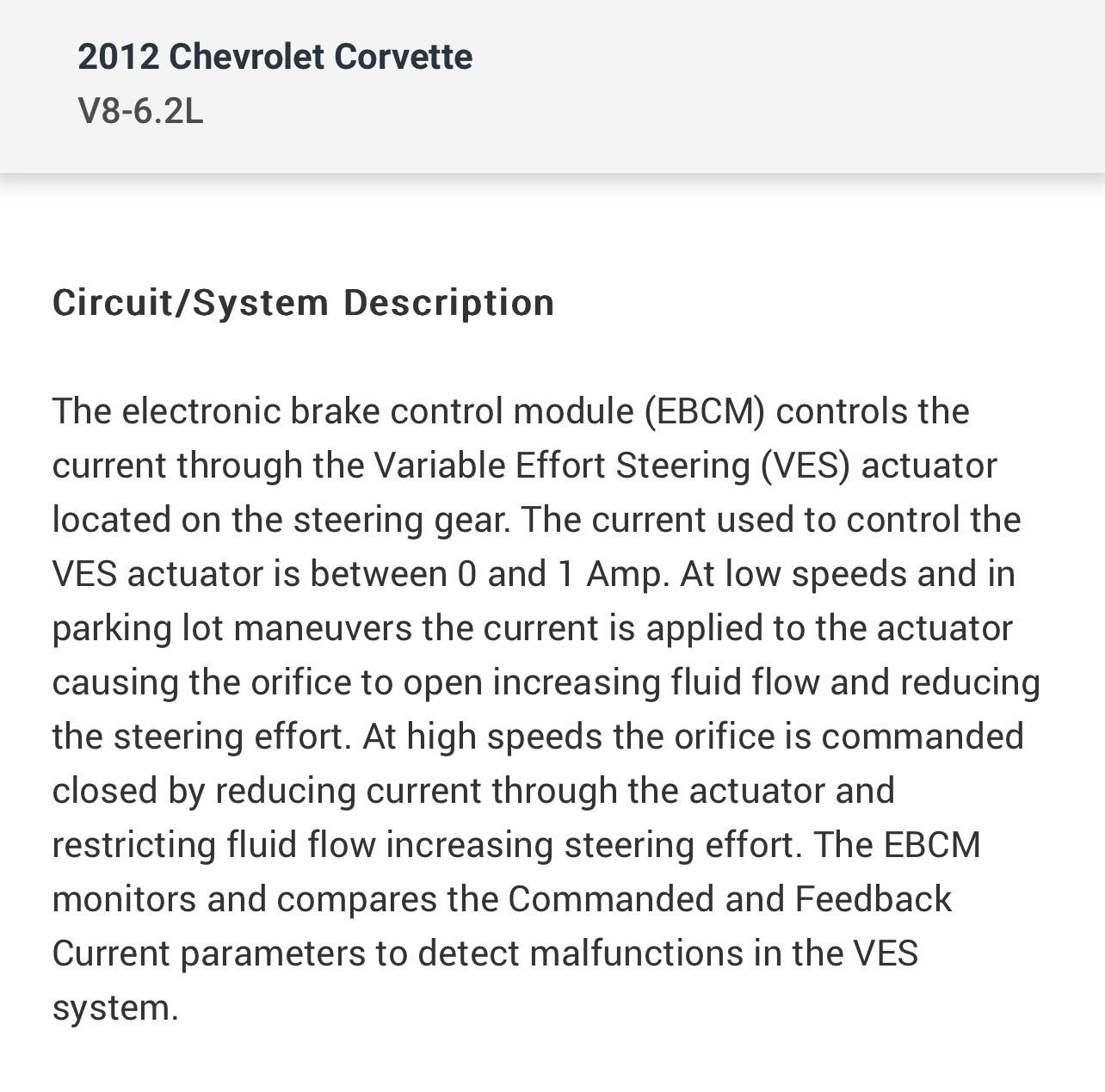

Does anyone know what voltage should come out of the actuator supply feed to the steering rack? My rack shows about 3 ohms, wires look good, but still getting the C0450-5a code?
Are you taking about volts or resistance ??…feed should be 12 volts…if low voltage check for open, short to ground or high resistance…if all good most likely bad EBCM.

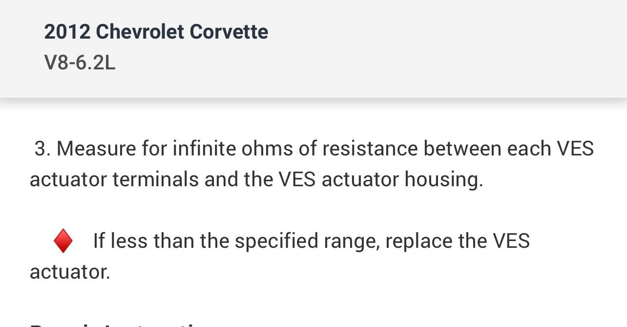

Thanks again, with the rack out and disconnected altogether it reads between 2.8 to 3 ohms

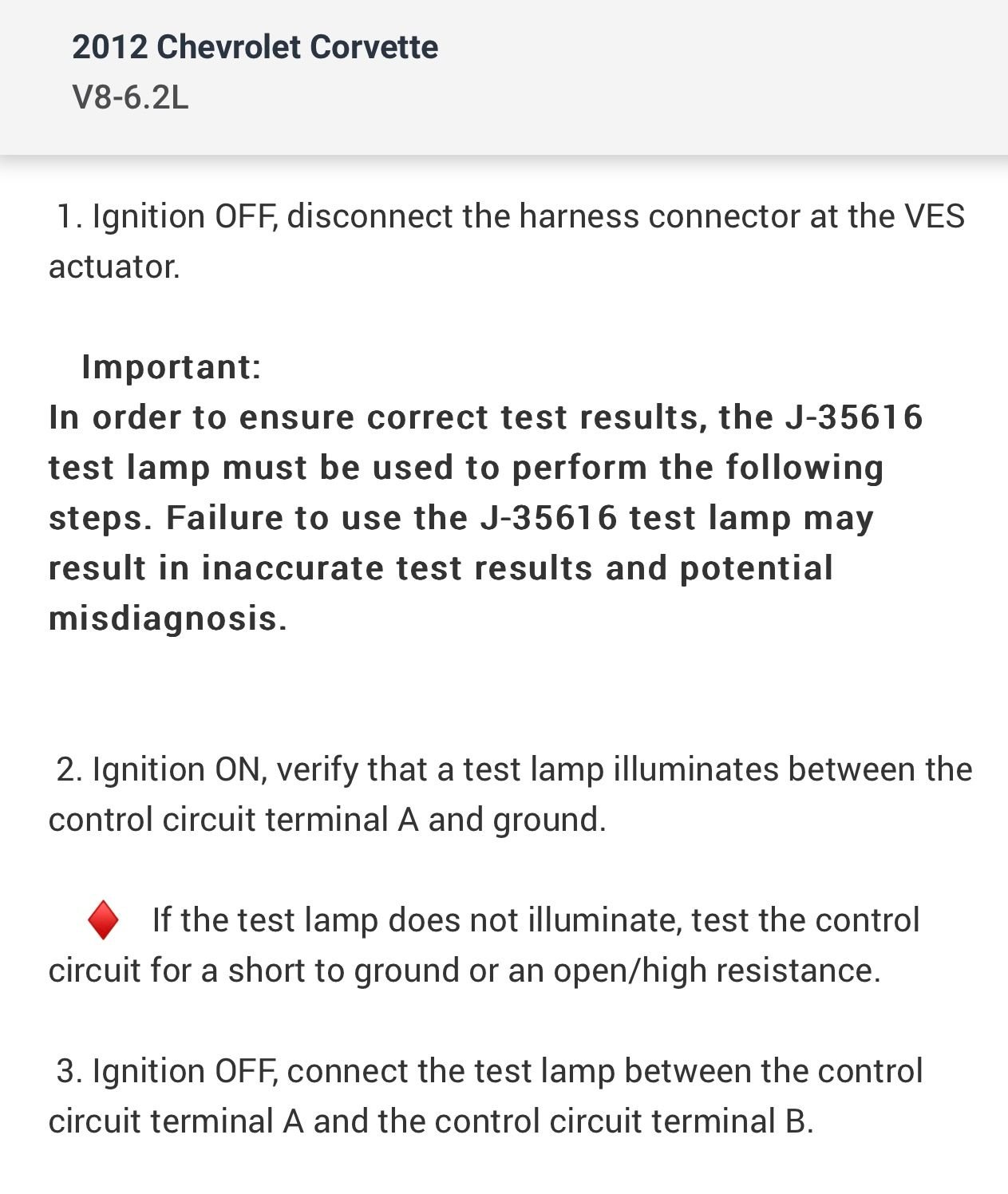

So, checked with ignition on, no voltage to the white VAR wire, the assumption is the EBCM is toast, I then took the harness apart, verified there is power, jumped the power to the white VAR and have power in the pigtail, is this a simplistic approach to confirm, or it wouldn't matter if fired or not, it would still have power?
