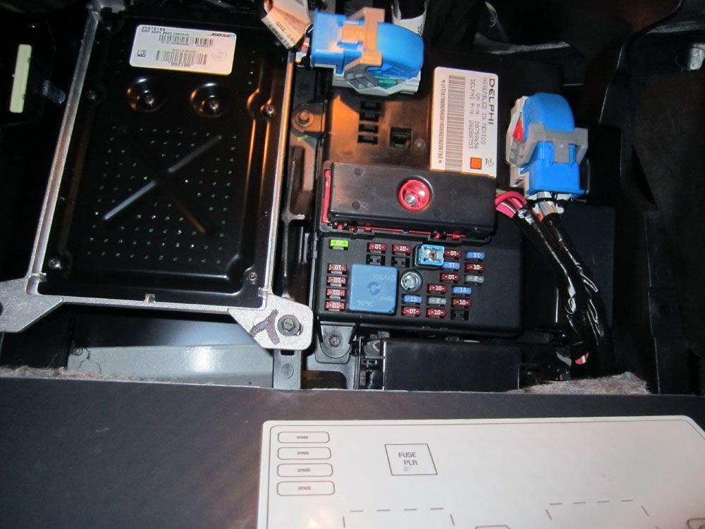

Besides the suggestions already given, you may want to check the Blue connectors under the passenger floor pan. Sometimes, a passenger may push hard on this pan, and disturb the 2 Blue Connectors, and that has been known to cause all kinds of issues, some of which you describe.
A forum member didconncted, made sure the pins were clean and good, reconnected, then use pencil erasers as a shim to prevent the pan from hitting these connectors again.
If you do want to disconnect these Blue connectors, make sure the battery is disconnect first.
Good luck, and report back if solved.
