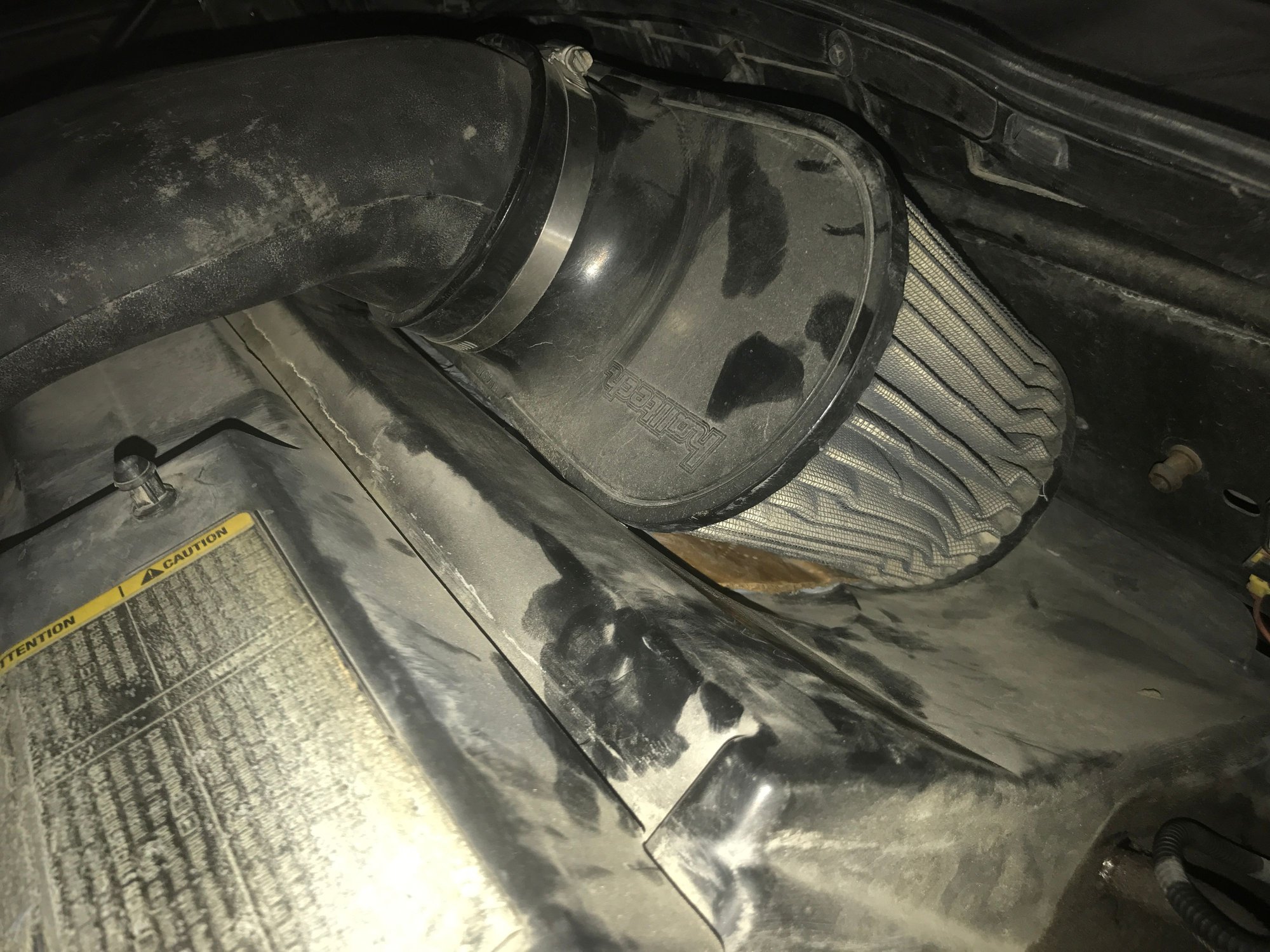

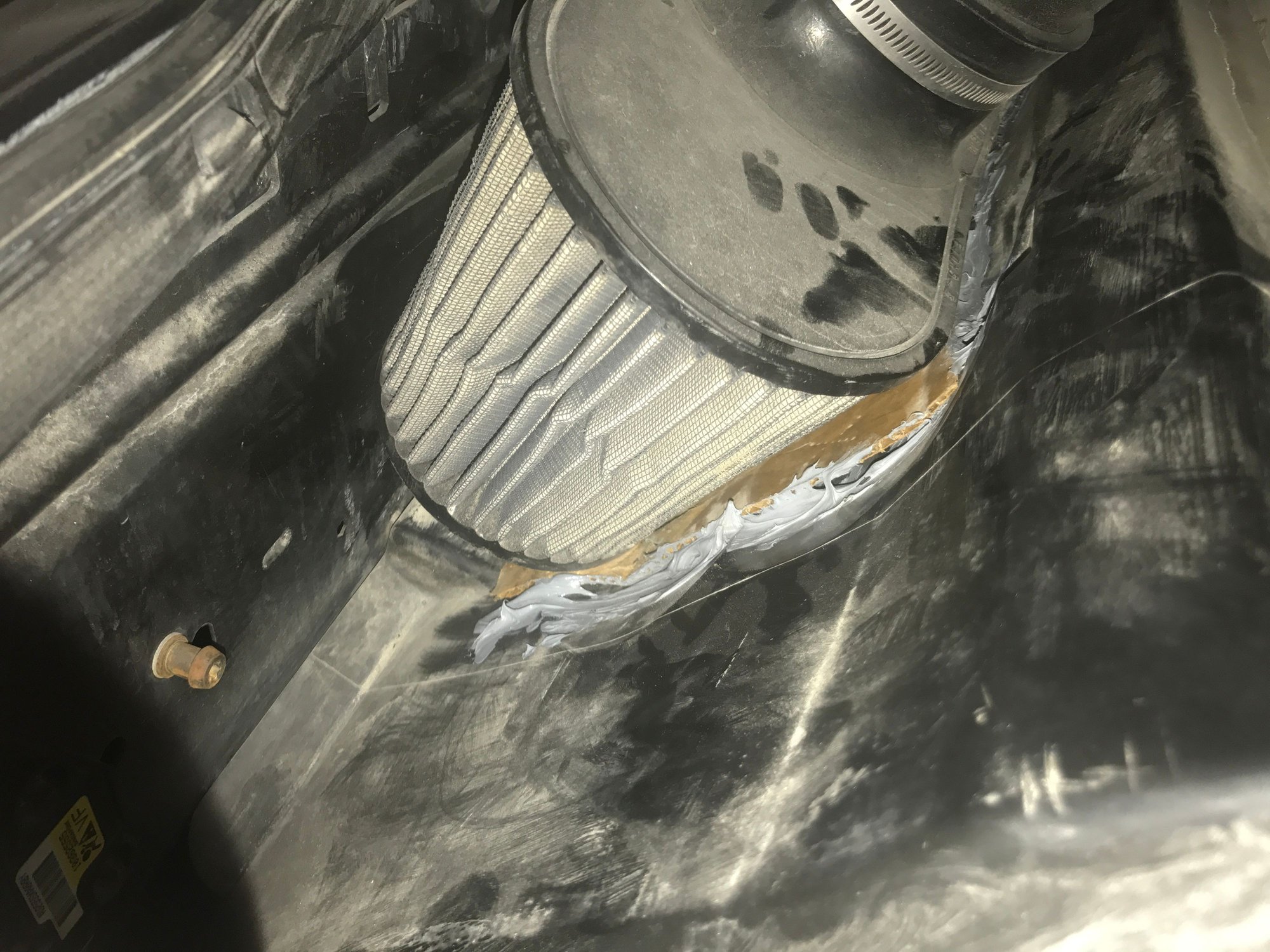

And this is what I mean with the radiator shroud
It is sealed now cuz there is a hole
Should I get a new radiator shroud
But also there two types and I don't know which one to get one with engine oil cool and the the other is without
Am not sure which on I have
Also where can I find that online to buy

Do you know if the radiator shroud should be a full one piece or is it better to have it cut
I posted a pic pf my car and I don't now it is stiched with some carton paper and it looks bad and it performs bad
So am wondering should I take off the stitching and have a hole behind the cold air intake or just get a new radiator shroud
I searched online but found no results about it when you install a halltech cold air intake
I also got the beheeve heat shield to install but I wana know if I should replace the radiator shroud before installing it
