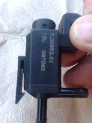

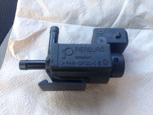

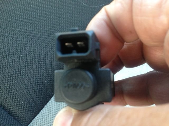

A friend (not a forum member) asked me to post this tech note:
NPP EXHAUST FAILURE
I was driving along when my NPP EXHAUST SYSTEM WENT INTO DEFAULT MODE. This is caused by the loss of vacuum to the system. Nothing you can do about it but hit the local dealer, unless you like the loudness on steady. It cost me $500.00 to diagnose the problem.
The system starts up front at the engine and works it's way back to the mufflers. Part of the line is steel with rubber couplers along the way. So they had to work their way from front to back. This is what took the time and expense. So I'm sending this out to save somebody some money. If it happens to you have them go direct to the part they found on mine first. That way you save some time and money to. They DO NOT stock the part, it has to come from the USA. The funny thing is that the part is made in Germany for GM. Just a helpful hint.

Well, still, it is a helpful hint, complete with a pic of at least one of the known culprits. By the way, Must Have, how much is the part that's pictured?
