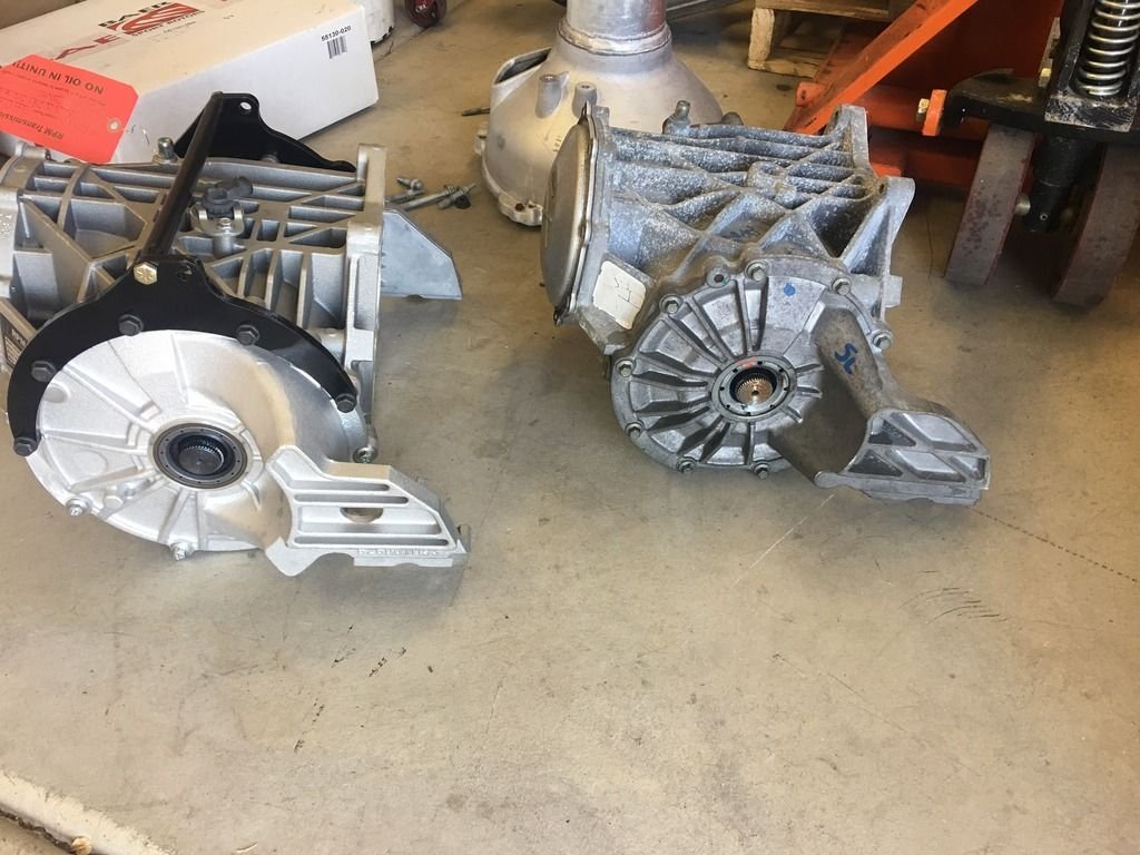

RPM just delivered the ZR1 case with 3.42 and brace kit for A6.
Compared to the base diff it is beefy!

Congrats man that upgrade looks great you'll will appreciate the extra go in all gears.
I weight mine and was 10 lbs heavier than the grand sport 2.73 diff by the way where did you find the girdle and did you get the pics...

I never received pics:-( Please try to resend if you can. I think you said you were having intermittent internet service at the time.
The braces were made by RPM to mate up to the 6L80e. Before I send the core back, I will weigh the two units. I feel the difference. The ZR1 unit has much thicker ribs and seems bigger on the sides. I’ll post pics after I get the tranny mated up with the bracing. It’s still being built right now.
