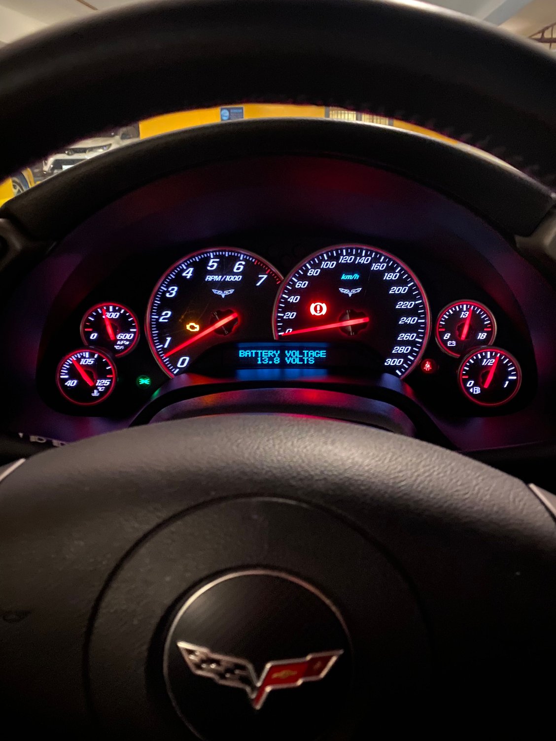

I have a 2007 c6 corvette (Canadian variant) ls2 6-spd with 21,800+ kms or 13,000+ miles. I recently had my alternator replaced because it was whining and the service charging system came on with an OEM ACDELCO Alternator 25888970 from Summit Racing. Fixed the problem and I can drive the car again.
After replacing the alternator, I suddenly encountered a new problem, the service charging system came back on. I cleaned up the ground terminals below the battery tray, and cleaned up the ground and positive terminals connected to the battery. No more service charging system, but volt meter reading was still a bit erratic but not as bad as when I didn’t clean them yet. When it’s cold, the volt meter reading on the dash is at 14.2. But at operating temp it would run between 13.4 -13.8 volts in city driving (stop and go). I brought it to the shop, they checked the alternator and the battery, they said that a volt meter reading from the alternator came out between 14.3-14.5 volts while the battery volt meter reading was similar. Although when it came to the volt meter reading on the dash it was reading around 13.4 -13.8 at operating temp. They also checked the ground wires and the ground wire connected to the starter and said it was tight and not loose.
I have been using it during weekends now, and I decided to start it up tonight (10/03/2023), and when it started the volt meter on the dash was reading 14.1 volts but the service charging system lit up again. I drove it around and it was driving fine so I really don’t know what’s causing this. Any technical advice would be much appreciated. Attached pictures below. One is during cold start and the other during operating temp.
Cold start
Operating temp (CEL due to straight pipe)

Would bank that the alterantor is not the correct unit, and has a voltage regulator in it, for the C5 instead. Or, horn or alternator sensing fuse is blown and why car is not seeing the voltage on the voltage regulator pins.
https://www.corvetteforum.com/forums...ng-system.html

I read the thread you sent me, I’ll check if it’s sending that code to the scanner. Could they still install a C5 voltage regulator even if I ordered a brand new OEM ACDELCO Alternator? I’ll check the fuses as well if it’s I didn’t order a rebuilt one. But I’ll double check to make sure. My corvette has no cats, no reso, and no muffler hence the CEL. The reason why it didn’t have it in the pic above was because I changed the battery! Lol. Thank you for the reply! I’ll double check everything.
