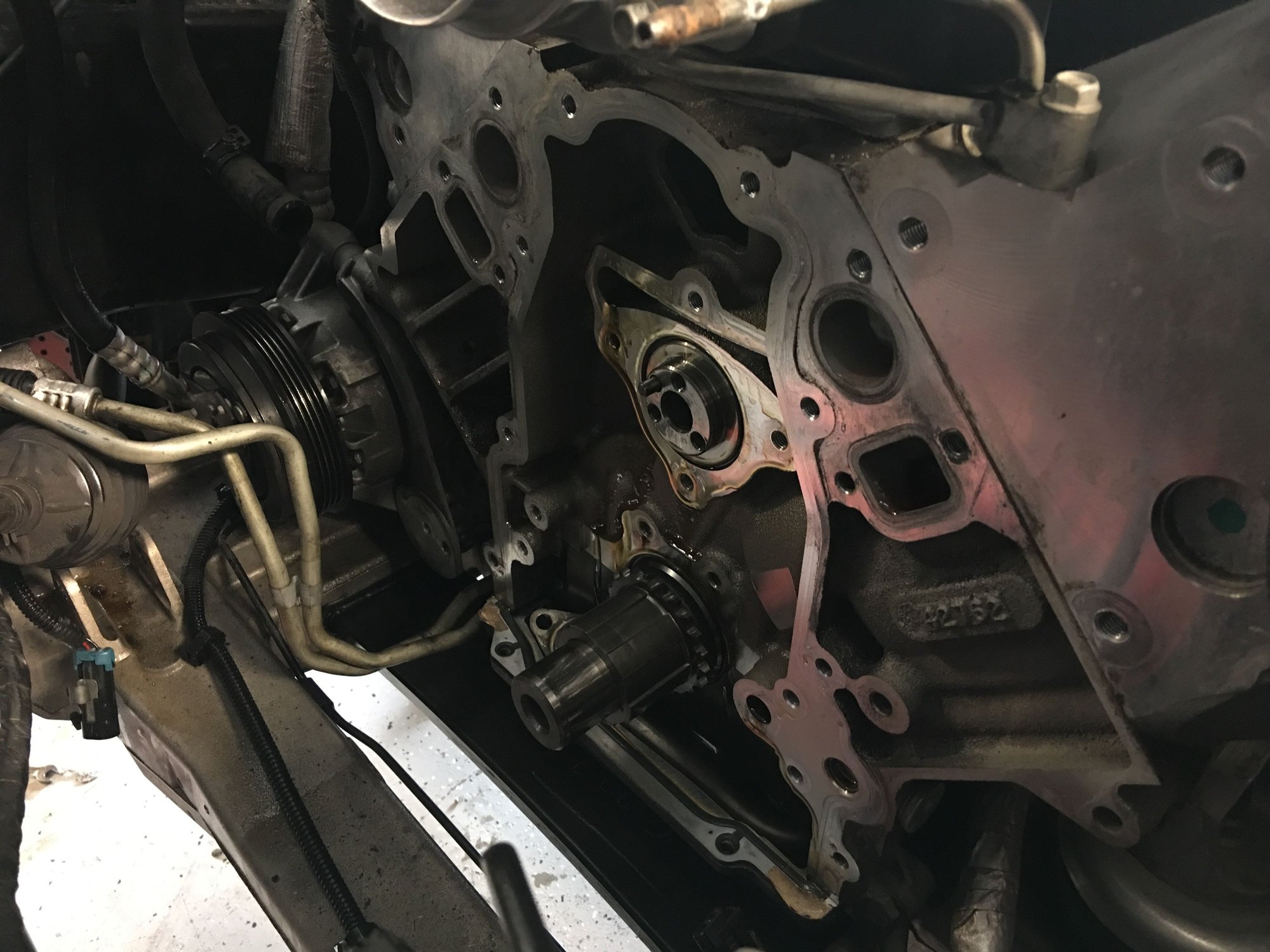

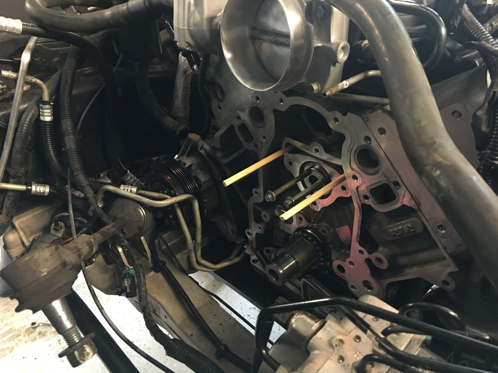

I'm one of those people. Changed my camshaft a couple of weeks ago without moving the rack. Changed to an ATI damper last year, same procedure. Need basic tools and 2 jacks, or 1 jack and 1 jack stand.
Should add before,that my c6z is on coil overs.
Remove engine mount nut from the subframe and lift engine with a jack as much as possible. If you've only got 1 jack, place a jack stand under and remove the jack.
Loosen the rear subframe nut as much as you can but keep them in place. Remove the front subframe nuts, watch yourself as the subframe will fall down at the front! Then pull it down as much as you can/think you need.
Now you should have enough room to pull the balancer, oil pump and front cover off. If it's still a tight fit you might have to remove the lower shock mounts to the control arms. I believe that's two 13mm bolts on each side.
Just make sure when you're putting everything back together, that the plastic seal on the steering column goes into the rubber grommet on the firewall. You will need to use the jack to lift the front of the subframe up. Be careful, check that's nothing is in the way as you raise the frame.
Good luck!
