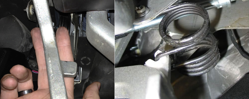

Either someone pulled the clutch lever assist spring, or it snapped instead.
Pick up a C5 clutch assist spring and install it. Hence the C5 smaller spring has less assist at both the top and bottom of stoke, so it give you a better clutch pedal feed back at the engagement point.
The smaller C 5 clutch pedal spring on the right,
Where it needs to be installed,
This will solve the clutch pedal not coming all the way back up to press the top clutch pedal button with your foot off the clutch, and then the ranger fluid methoud change will solve the changing engagement points of the clutch pedal.
And yes, grease the hell out of the spring, including the ends where the spring ends will go into the nylon bushings, and really grease the U section and tab where the end loop will goes into. If you don't, will be getting squeaking noise when you use the clutch pedal.

Thank you! The clutch actually seems to be operating "correctly" now. The engagement point is different from when I first started driving, but I think the engagement was incorrectly low at first, and now it's correct in being in the middle of the pedal throw. Just took some getting used to.
I saw the C5 spring fix. I'll probably do that at some point soon. But it's driving okay now and I'm in no rush to get back underneath those pedals! I'm a pretty small guy, so idk how other people do it.
