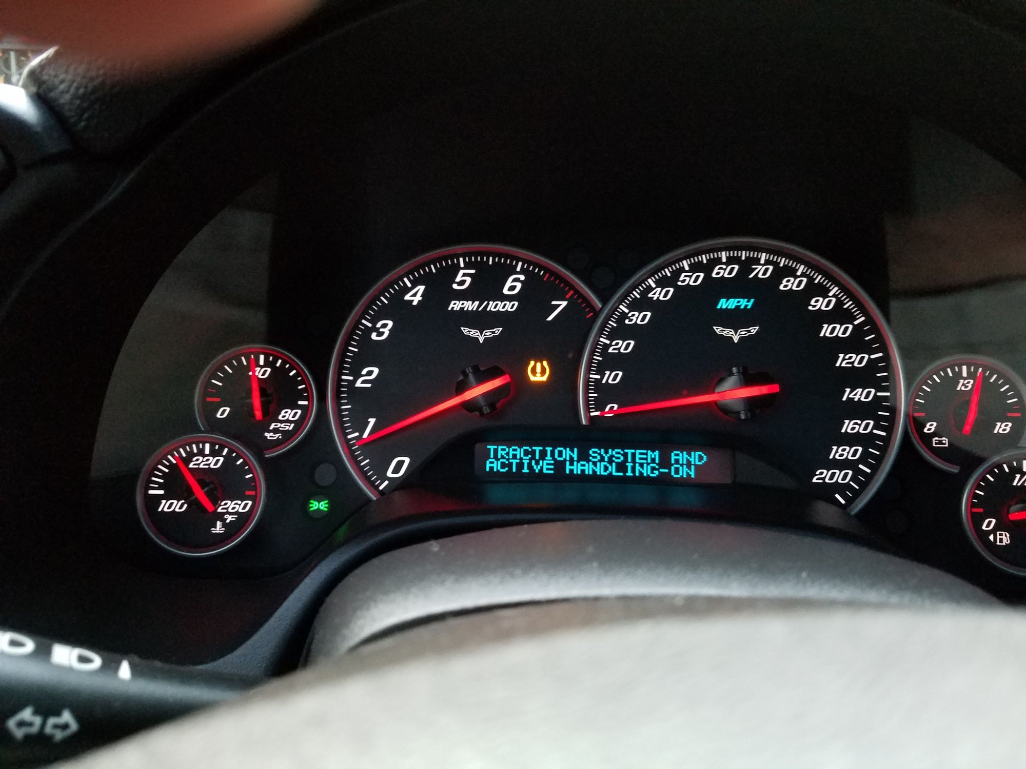

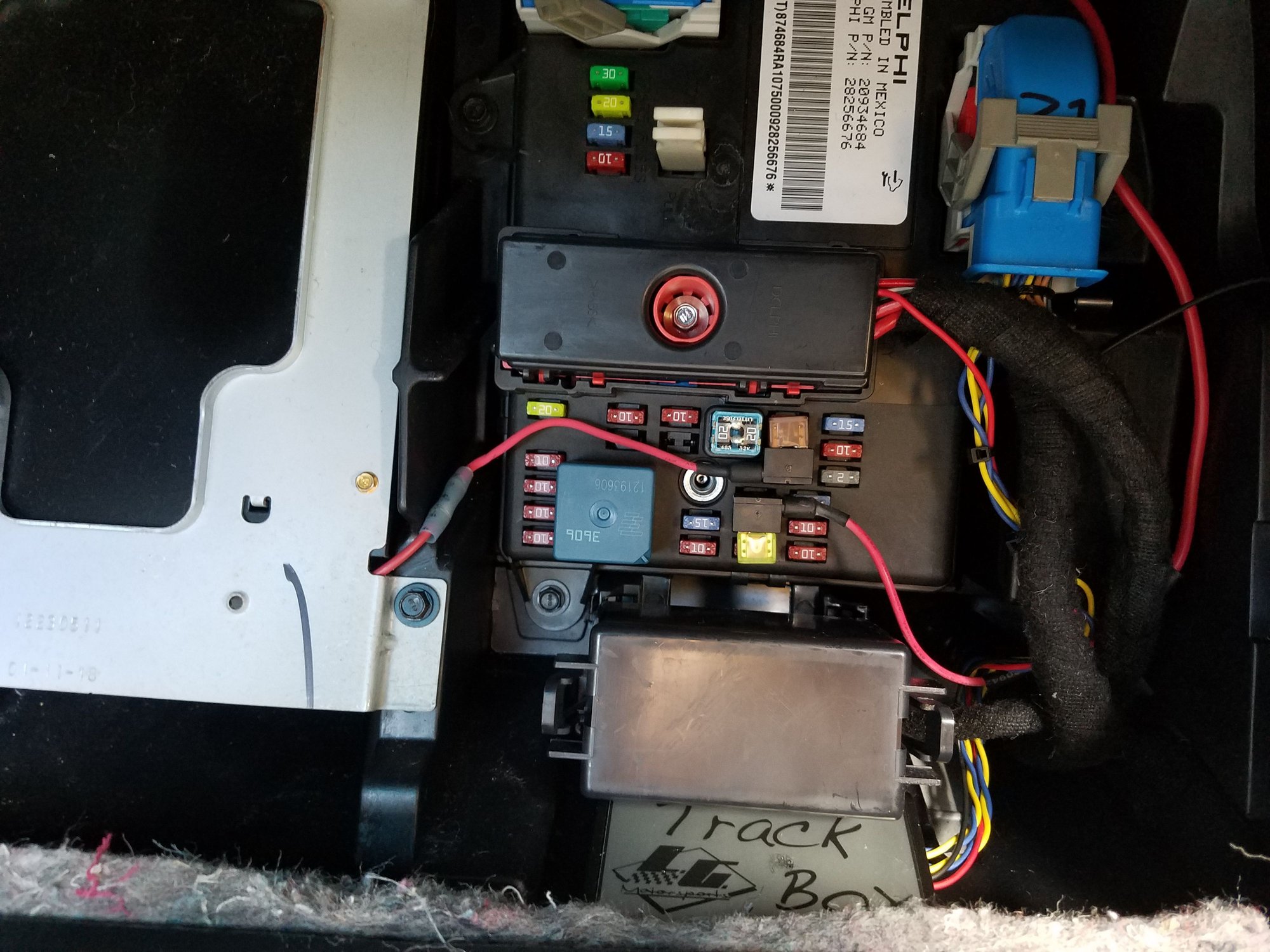

I installed the LG Track Box and it works as advertised. Traction Control defaults to Off everytime the car is started. Also the Traction Control and Active Handling works without having Tire Pressure Sensors. All in Track Mode. The Tire Sensor light still comes on but it No Longer effects Traction Control or ABS. You can also set it back to Street Mode and use your Tire Pressure Sensor again. LG Track Box as Shipped
Installed
Traction Control and Active Handling On without Tire Pressure Sensors. Yes, the TPMS light still comes on but who cares. Everything works now.
