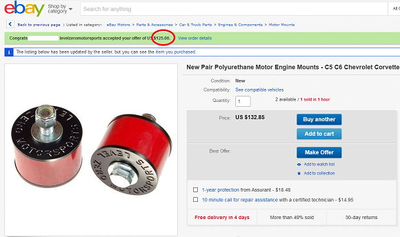

Just a quick word on the Level Zero m/mounts mine came with a standard 1/2 inch bolt which is thicker diameter than the 11 mm factory so two options, drill to enlarge the cradle holes and mount brackets holes larger or just get a pair of 11 mm bolts of same length, I recommend the 11mm bolts with same tread pitch so you can use factory mount nuts.
Just got these and they are really nice. Probably going to go with 11mm bolts and not drill. Noticed the bolts with these are only grade 5 and wondering what grade you went with and where you're at on HP?
8.8s are easy to find but I'm thinking 10.9

560 hp 575 tq wheel n-a max effort heads and llsr cam E85 stock block ls3. I recomend the 11mm bolts I did drill but would do bolts next time
