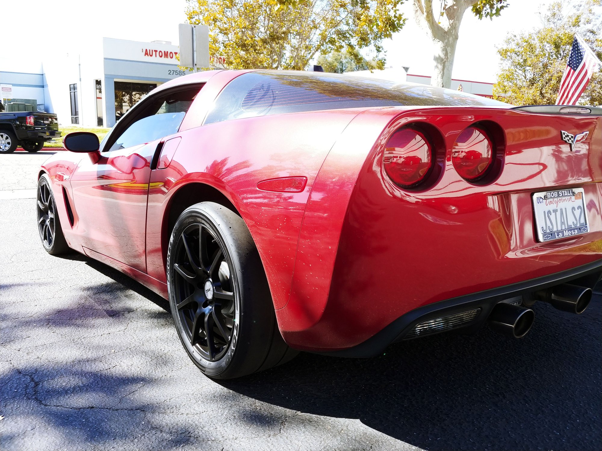

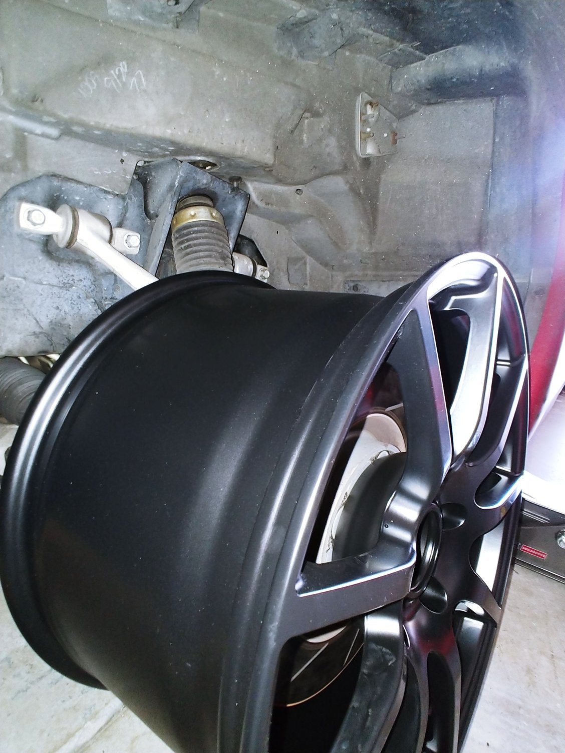

Default It Works! 18x10.5 square set up with PICS.
Meatier than expected. The fear sets in they wont fit.
Difference in rear Bridgestone RE11s 285 series to Toyo RRs 315 series. Toyos are substantially shorter front and rear.
Rear test fit. Inside lip looks like it won't clear without cutting, but does on the ground.
Test fit front. Same concerns but it works on the ground.
On the ground. Front actually tucks in a bit, rears are jjuusstt out a bit from flush (Don't care.). Pardon the dust!
Rear quarter view.
Booty.
So I'm going to go ahead and bring this back from the dead from earlier this year, so all information is in one place. I've been referencing this thread heavily and a couple other older ones for the last few weeks IOT get ready for Auto Club Speedway Roval Nov 4th/track days. Basically put all my faith in the forum and it worked out great so far with no real clearance issues. No rubbing although it was just an easy drive on it so far.
  1. TSW Nurburging or Interlagos will work. 18X10.5 65et all around.
  2. The Toyo Proxes RR will work fine. 295 30 18 fronts, 315 30 18 rears. You could go 295 all around for tire rotation purposes.
Alignment is done and super conservative right now PFADT street specs, but plan on at least -1.7f, -1.0r camber without issue and go from there.
Car is a base body 2005 C6 with F55 stock suspension. My inner fenders were/are the worst, and I thought I'd need spacers or maybe even cut into them; not the case. They have been chopped a bit for boost etc on the bottom but that has only made them worse. I took lots of pics for you guys since there's only like, ONE decent picture on the forum that I put all my faith and trust in. Now no one else will have to lose sleep while waiting on their shipments from amazon and tirerack!
