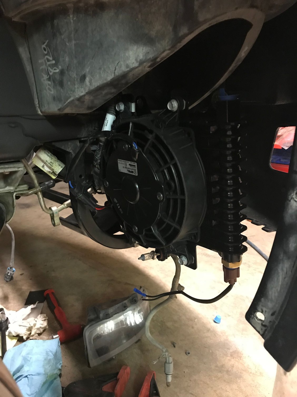

So I am installing a B&M Super Cooler and directions show an in and an out flow through cooler.
My question is does anyone have information as to the in and out coming from the trans.
Car is n 08 base car 6L80
Just want to make sure i don't run reverse through cooler. It appears as the temp sensor is on the intake side.

As far as the cooler in and out it really doesn't matter later when service comes you may be pressed to know like I was so I marked an arrow with a electric engraving tool rite by the engine area for reference like when changing trany oil. will lift and look and get back with you.
Here we go referencing by connection of tubes to the transmission the lower is return.

Racer, where did you mount your supercooler?

Right front fender behind driving light. Had to fab mounts.

Left and right behind fug openings pics before the 8 inch fans went in coolers are 7 x 9 inches.
