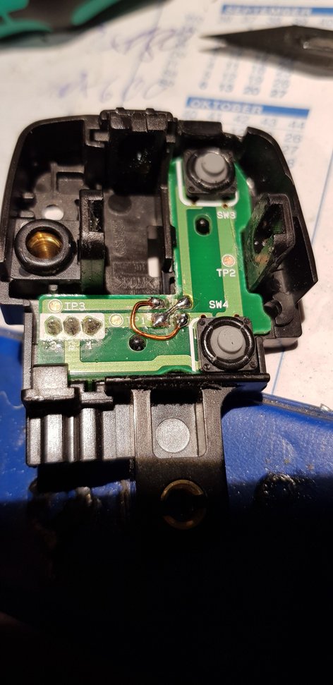

as an alternative, I can offer soon this version:
In the pictures You see an unpainted version, nearly every paddle can be mounted, they only must have a flat mounting surface. Material is ABS, can be sand, painted etc..
The paddles on the picture are alloy ones which are screwed.
The electric modification can be made by modification of the plugs or like this:
I will test it when my Vette is back from repair
