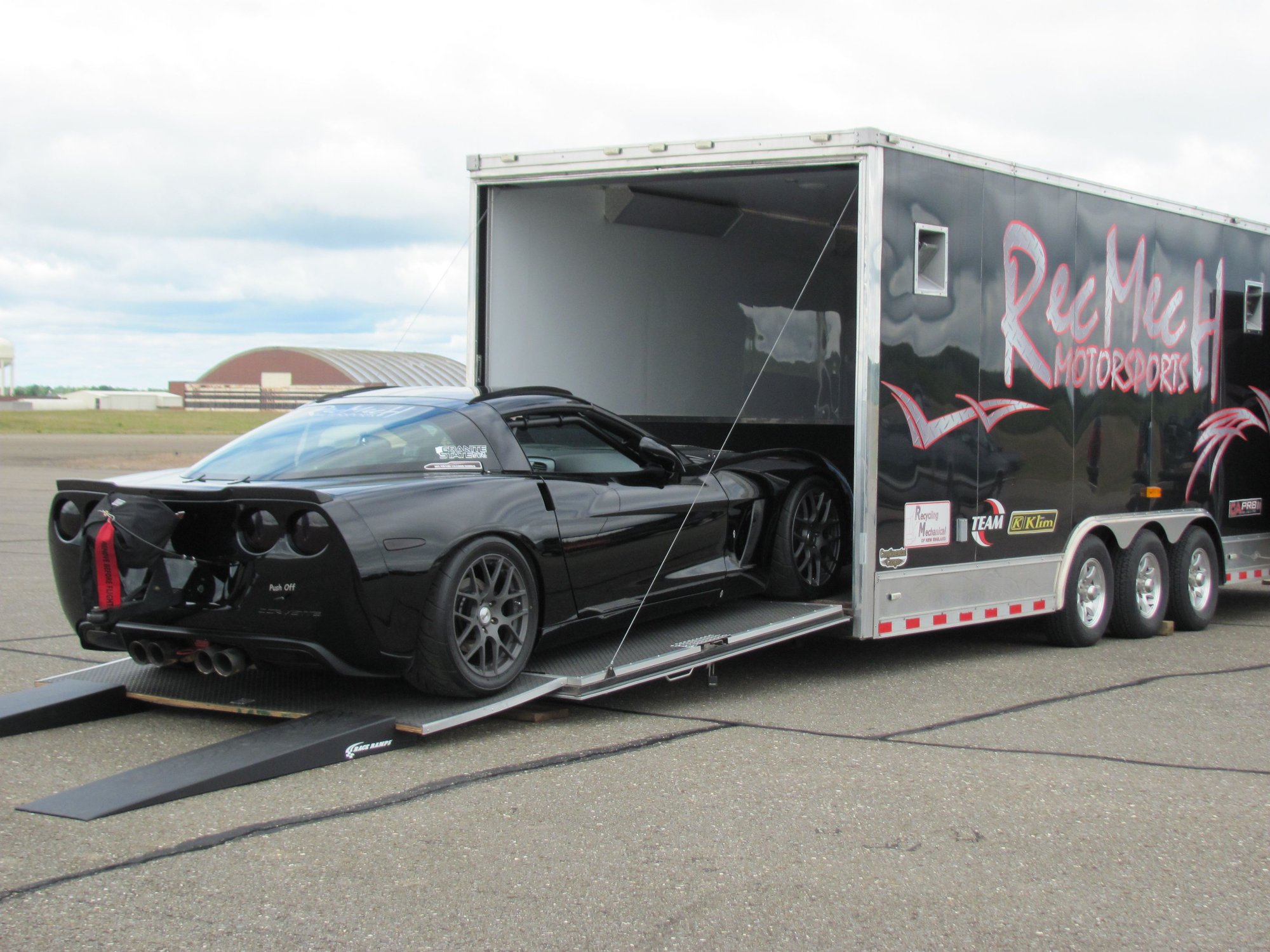

Older pic, but it shows us using all the tricks... Trailer hitch jacked up (we normally go higher that what is shown here), blocks under the main door, door flap, and race ramps (also have built in beaver tail). I still just about touch as it breaks over the door/floor transition. Also very close to the splitter in spots.
I have been winching the car in and out since day 1 with a wireless remote. Car is lowered on coil overs.
I didn't realize how much the flap flexes until I just opened this...

I believe the ramps shown in the photo in the previous post are the RR-TR-5. You can compare this ramp to some of the custom Race Ramps available at this link.
https://www.reverselogic.us/trailer-...--loading.html
The drawings shown on that page are scale, so it's easy to visualize the relative difference in the incline, length, and height of the various ramp models.

Correct, RR-TR-5
Couldn't be happier with them!
